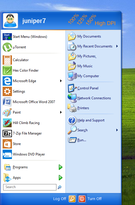

XP Blue BBT rev B (Classic 1 and 2)
The fat Blue Bottom Border is back, now with Transparency! (BBT)
Please be aware, it can not look and function same as original.
It is a compromise. Skinning can only do so much.
Tried with CSM 4.1.0 on Win7/8.
After downloading file, paste in skins folder. Usually C:\Program Files\Classic Shell\Skins
Exit CSM, restart CSM, and go to "Start Menu Style" tab.
Pick Classic or Classic two columns.
Pick "XP Blue BBT" in Skin tab.
If you want to have at least the power button on the blue bottom, click on the Extend right text.
It can not be white text, unless Ivo has some overide trick in CSM settings?
I find if I extend the left text, the search box fits nicely. One has to drag a separator
in the Customize Start Menu tab, and drop it just above "search box".
This will give a buffer space for item button above it.
ps This is only the blue XP. Green and silver not included. File size at 1.38MB already.
I cheated and put a screenshot of real XP menu in bitmaps.
The alternative variation was a blend of original, Classic Shell, and my own.
And as always, if I left some bugaboos, sorry. You can tweak the text and bitmaps,
and upload the improved menu to share. :)
I decided to include more bitmaps for Transparency. They are at 230/255 Alpha layer,
using fullalpha. If you want to use menu in Win 7 with fullglass blur,
one would need to edit the bitmaps to 200/255A or lower,
and change opacity text to "fullglass".
One more thing, if you want to live dangerously, and have icon buttons for shutdown sub items,
on the blue bottom border, fine. GauravK shows how to do it. For me, after accidentally
hitting the log off button, and losing my work, I pass.
The all knowing GauravK provides a solution for that:
"There is a "Confirm Logoff" option in the Start menu settings".
Note. The extended bottom paddings will not work in Hi-DPI.
RevB removed large green arrows on split buttons, added face variation.

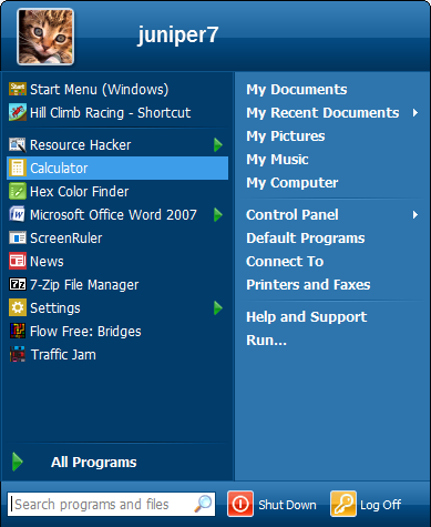

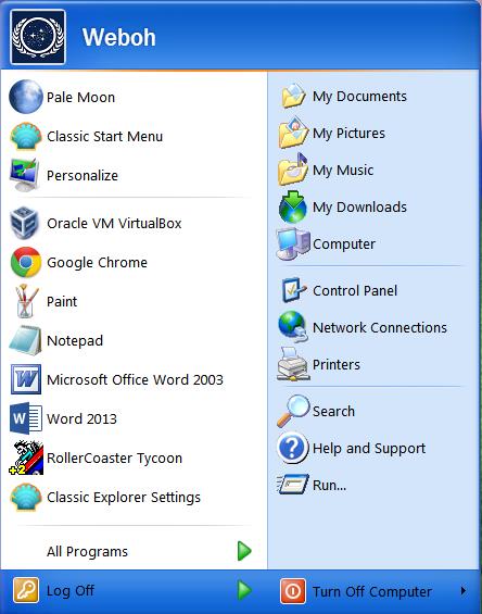

Here's mine. To get it like this, I had to extend the left and right borders, and add log off directly after programs. XP's All programs doesn't have an icon, so I typed "none" (without the quotes) to get it blank. And to get the buttons on the left to have the blank space on the bottom instead of the top, I had to add empty buttons below the rest of the things on the left. All that's missing is being able to add white text to the bottom, removing the arrows after log off and shut down--while still keeping the sub-menus--and separating the log off button from the left row, so that it can be more to the right, like it is on XP.

Hello Weboh.
That's funny. I thought I was helping you, and find out you did it already:)
First I thought-piece of cake. So easy, until I switched to small icons. All yucky spacing.
Took me a day just to sort that one out.
Yep, I messed around with a lot of things as well.
I made buffer/padding icon buttons, with bitmap picture inside of bottom border.
These were placed to be invisible, to push the log off, and power icon buttons to proper areas.
I even has the white lettering for "Turn Off Computer" right on the menu bitmap. The selection button,
with the exact invisible cutout lettering, to let it show through as white when selected.
But of course, as the menu shrank and expanded, it went way out of alignment.
These are not on uploaded menu. It had to be as simple as possible for others to use.
I wonder if an icon button has to be square? If not, the log off picture and text,
could be assembled as a rectangular icon button?
I just noticed both our menus have different separators from real XP.
Original is shorter and snubbed out. Yours looks better.
Anyway, that's about as far as I want to take it,
getting even closer requires a lot of head scratching.
I don't like the sight of blood.
The weekend is over, and it's time to go.
Bye Weboh, the XPerienced.

Nono, you totally helped me. :) This is just my configuration of your skin, that I posted for reference for everyone else.
Well, I wouldn't mind having it. I'm actually spending more time making Windows 7 look like XP than I did using XP. :P It's fun to me.
I assume it's different because I'm using it with a third-party Windows XP skin.
And sadly, Icons have to be square. I wish Classic Shell didn't require changing so many things into limited icons, but then again, at least we have it. Windows 7 (and especially 8) would be a nightmare without it.
Maybe GauravK or someone could try and fix some of the issues we noticed?
And if you need a project for next weekend, I'd appreciate it if you did this, or made the Silver version of this. :)

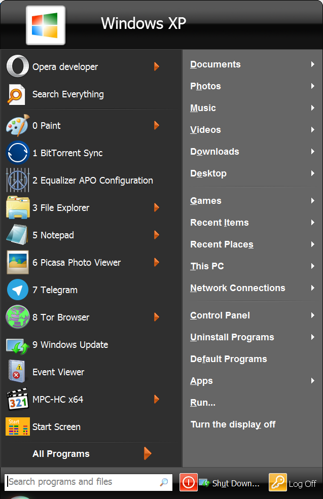

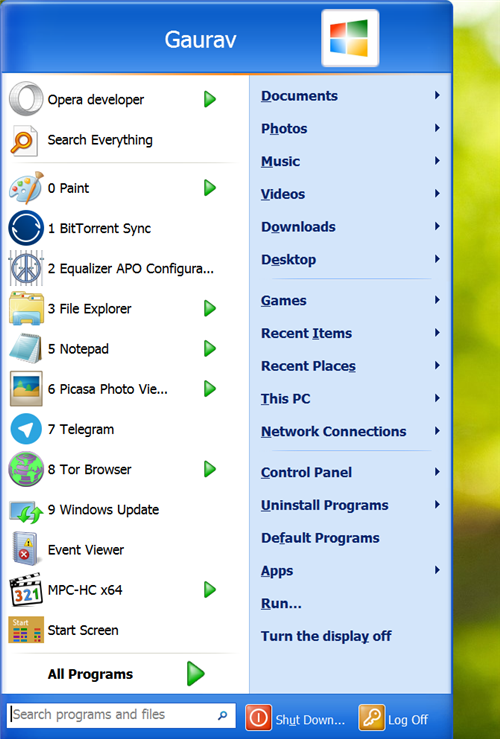

Hey that's nice and quite an effort, juniper7! And that's a clever idea, Weboh to move Log off below All Programs. It almost looks like the XP menu except for the differences you both pointed out.
juniper7 wrote:
If you want to live dangerously, and have icon buttons for shutdown sub items,
on the blue bottom border, fine. ..For me, after accidentally hitting the log off button, and losing my work, I pass.
There is a "Confirm Logoff" option in the Start menu.

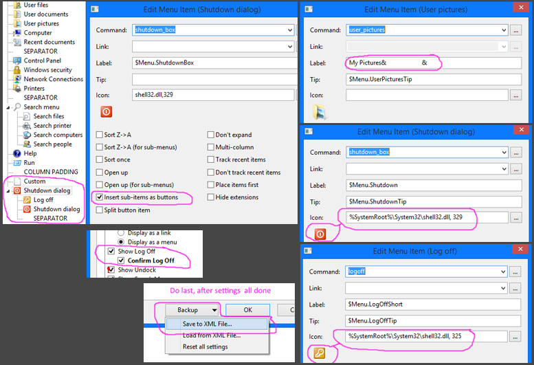

This is another version, my last attempt. At one time the bottom lettering was clear type. This one looks like original XP chunky text.
There is no way to make like original. If I squint my eyes from 15 feet away, it kind of looks like old xp.
This is closest I can make, but as I said,
requires lots of manipulation in "customize start menu settings".
Check out picture for visual instructions.
If using small icons option for main menu, minimum menu spacing will need to be increased further,
so add more blank spaces in between the & and &.
At bottom, it is only the icon buttons that will be highlighted with mouse over, not the icon and text.

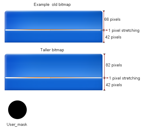

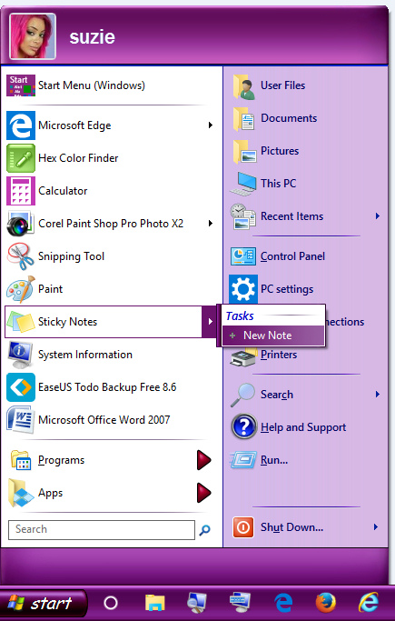

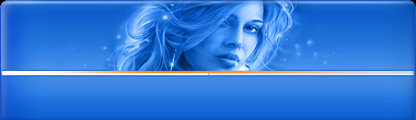

I added option to show top thick border without name or user picture, because, well,
blue is beautiful you know. Also the slices are different, so around two thirds of top border could be used for game logo,
or say the face of a blue girl staring at you. If you know how to use Resource Hacker, you will find a test bitmap of her.
She is really airbrush hood painting on a VW beetle. Credits to painter.
To be a simple menu, the selectors are only color referenced, so no fullalpha, fullglass transparency is available,
unless real 32 bit selector bitmaps are put in place.

Added xml file to make it easier to use skin.
Just save .xml file to location of your choosing.
Click on backup button at bottom of CSM settings.
Pick "Load from XML file", open the "XP Luna BB xml file.
This will roughly set up the functions/look.
Only problem with this way, is every menu will follow same configuration.
You will need to "Reset all settings" to use a different menu skin.

The xml file, tells CSM to use the LogOffItem.Icon=%SystemRoot%\System32\shell32.dll, 325
and ShutdownBoxItem2.Icon=shell32.dll,329
Looks like you are going to have to manually find the icons, in a different .dll location in Enterprise, with "Customize Start Menu tab".
or download them to folder on drive, and instruct CSM to find them in that folder.

Just remembered, this girl is still hiding in the XPLuna BB file from way back. :)
If you want to see her. Swap bitmap 29 for bitmap 2
I put the girls face option variation in XP Blue BBT rev B. (The first skin at top of post)

PostPosted: Mon Feb 08, 2016 4:08 am
Update for high DPI?
I tried it Gaurav.
Can only work in 3 sizes 100%,125%,150%, nothing else.
XPLuna TXT HDPI (text on blue bottom) and XPLuna ST HDPI (Standard XP look-a-like)
For Classic 1 & 2 Columns.
High Dots Per Inch experiment. Only available at 100%,125%,150%. Other percentages will not work properly.
As the bottom text is embedded into the bitmap, it's stuck in one place,
and everything else has to be adjusted to compensate for it.
What looks like qty one Classic 1 column, and qty 1 Classic 2 column menus from viewer point of view,
it really is qty 12 menu bitmaps!
It would be qty 36 menu bitmaps to have all colors. Too much work, so there is only the blue menu in this zip.
Not sure if this is going to work correctly, or not on a different computer. See PS below, for possible odd bug.
It has regular size XP menu with the text & square buttons on the blue bottom.
Has option to switch to 125%, so the text/buttons line up properly.
In Windows 125% setting-it works. In CSM setting to 125DPI-buttons go out of alignment. It is not same as percentage.
Starting point of 96 dpi = 100% So to get the extra 25% CSM would need to be 96 x 1.25 = 120 DPI. Then it works properly.
If CSM detects 150% text size, it turns on automatically to proper proportions. In CSM, that would be 144 DPI setting.
It can be quite picky about the exact required amount! Maybe wasted two days on it. Best to use Windows size adjustment in "Display Settings".
Well at least try it once, then delete if not happy.:)
Note. The " XP ICONS.zip" name is a bit misleading. It has skins, .xml file, and XP icons all inside.
It requires some actions on your part to set it up:
1.Unzip the "XP ICONS" folder. Put it straight into Drive C.
(Don't hide it in another folder in Drive C)
2. Copy the "XPLuna TXT HDPI.skin" file, and put it in the skins folder of Classic Shell.
3. Open up CSM settings, select "XPLuna TXT HDPI" in "Classic with two Columns" style.
4. Click on the "Backup" button at the bottom of CSM settings. Click on "Load from XML file"
Open the "XPLuna TXT HDPI.xml" file in the XP ICONS folder.
5. Lastly, reset user name text in "Menu Look" tab, to default.
This should set it all up, so the original XP icons are showing on second column.
(It changes configuration, to link up to the XP icons, make so shutdown buttons get small,
and adds some blank spaces to push second column out a bit.)
If all this fails on a different computer, sorry, did the best I could. :)
I put another skin file (XPLuna ST HDPI.skin) & (XPLuna ST HDPI.xml) in the XP ICONS folder as well.
It is just the Standard (ST),skin. Does not need matching xml file, unless you want the XP icons.
It can have proper sizing in reg, 125% & 150%. Just nothing on the blue bottom,
which in some cases is better than a lot of tweakin with DPI.
Post Script.
Just before uploading, I noticed something weird about the "custom menu" item in "Customize Start Menu" section.
I have a custom menu item sandwiched in between column padding, and shutdown dialog. It keeps the run button from going on the blue bottom.
When 2nd column icons are turned on, custom makes an invisible space. Good.
But when no icons option is turned on, the custom space dissapears! Huh.
I don't know if it is a bug, or designed like that. Best not to use small icons, & no icons at 125%, 150%,
unless you put lots of items in first column.

Looks sharp and in place buttons at 150%. Thank you. :)
PostPosted: Mon Jun 06, 2016 6:30 pm
XP suzie (classic 1 and 2 column)
This is suzie copycat menu for CSM.
From way back in 2001. Someone changed the color of Luna XP to this rich purple.
Difficult searching on internet. I don't even know who made it, to give credit to.
I've had it forever. The only purple menu I could use longer than half an hour.

PostPosted: Wed Dec 07, 2016 10:58 pm
What can I say juniper7 except it's perfect and high quality and a lot of hard work!! :mrgreen: ;) :) :D :P :mrgreen:
The magnifying glass icon for search / (x) icon when we begin searching is smallish at high DPI. Everything else is perfect!!
Can you PM me your PayPal so I can show my appreciation by donating some amount?

Embedded7 Plus [7 style] Use with CSM 4.3.0
Embedded plus Zune plus Royale plus Noir plus HiDPI
Only HiDPI 150% I cut out the 125% size.
Gaurav had already made an impressive Classic 2 style, all in one skin.
This is the 7 Style version of the same skin.
Embedded7 Plus.skin7 [719.5 KiB]
Downloaded 14607 times

Embedded7 SS Plus [7 style] Use with CSM 4.3.0
Same type of skin with the additional icons image in second column.
To get it working, the xml file has to be loaded, to align the second column.
Same deal with the entries stuck that way. No rearranging. Can only add a couple extra at bottom.

Thanks juniper7. Your skins are always polished and it's a challenge porting classic with two column skins to 7 style but you do a superb job. For sake of completeness, these are an excellent addition to the collection of skins we have here in the forum. :)
Enjoying it :P

Can anyone help me with enlarging profile picture in this skin? EDIT: By "this skin" I mean XP Blue BBT from opening post.
I have changed
Code:
[USER_IMAGE]
User_image_size=48
User_frame_position=10,8
User_bitmap=13
User_image_offset=2,2
[USER_IMAGE OR USER_NAME]
Main_bitmap=2
Main_bitmap_slices_Y=66,1,42
Main_padding=7,71,7,45
Main2_padding=7,71,7,46
to
Code:
[USER_IMAGE]
User_image_size=64
User_bitmap=13
Main_bitmap=2
Main_bitmap_slices_Y=82,1,42
and replaced Bitmap6 and Bitmap13 with bigger ones, yet it doesn't work. No idea what to do next. I tried to change various padding values but it didn't help.

This is how it looks without Bitmap6 changed.
https://i.imgur.com/Kbb1poc.png
Just need to enlarge the blue part at the top, so profile pic doesn't look so displaced.
And this is with Bitmap6 changed
https://i.imgur.com/LzTvIDB.png
Pretty sure I'm just messing up something with Main_bitmap_slices_Y, but I'm also sure the values in *.bmp file and my edits to the skin are the same. As I wrote earlier, I have added 16 pixels to original Bitmap6 file and changed 66 to 82 in Main_bitmap_slices_Y=66,1,42 I must understand it wrong.
PostPosted: Sun Oct 15, 2017 3:19 pm
Have not looked at the revB file for awhile.
Variation 1 Original two column with picture has Main_bitmap=2
Variation 2 Flatter bottom two column with picture has Main_bitmap=6
Variation 3 Transparent top/bottom two column with picture has Main_bitmap=17
Variation 4 Transparent top/bottom with face two column with picture has Main_bitmap=28 with different dimension slices.
along with same user picture frame User_bitmap=13 for all variations. Its frame is 52 pixels high.
Ok, now trying to figure what I am seeing in your pictures.
For first picture, the main menu bitmap looks like variation 2 with flatter bottom.
The second picture, I might be wrong, looks like variation 3 altered transparent main menu bitmap.
The vertical slices don't look right. See my picture where the vertical slices should line up.
Your picture frame, black part show 64 pixel height.
It's ashame you put the red over the user picture. Does user picture show, and just hiding it?
Kind of looks like you want a round user picture?
If you just want a round frameless user picture, steal the 64 pixel bitmap 18 from Metro skin.7
and use this text instead.
User_mask=13
Can add a (frame) User_bitmap to be above with a different number.
If all I have said is too confusing, upload your modified skin and we can see if we can get it working the way you want. :)
