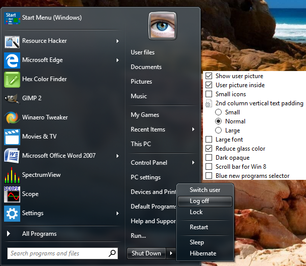

I found a nearly finished "Smoked Glass" [7 style] conversion skin.
I just had to make a bigger Hidpi user picture from the classic style. Done.
This skin works similar to original classic style skin.
On Win10
The trick to get the greyer look is checking "Reduce glass color" skin option.
To get all the color out, go to "Menu Look" Tab and set "Glass opacity" to "0" or,
uncheck "Enable menu glass" option. That will switch on Ivo's modified alpha opacity look. :)
If you want darker still, pick "Dark opaque" skin option that sets menu opacity to region.
Can always uncheck "Reduce glass color" and use "Override glass color" option to use the color picker.

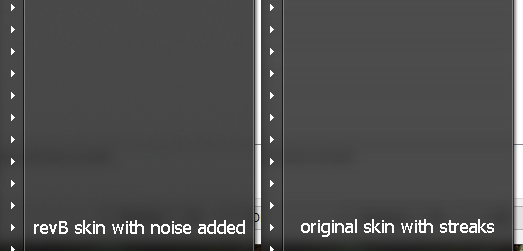

In some conditions, the original skin shows horizontal streaks on the menu.
I used Ammonia D (dither noise) to reduce those streaks, same as on the 7 style.

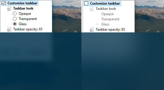

I made a picture of the taskbar on top of the white settings window box. (I pulled up the taskbar)
On the left is with Classic Shell taskbar turned on using glass default option.
On the right is the default Windows 10 taskbar, which has been updated to use Acrylic transparency.
They boosted the color, changed the brightness, added noise texture along with the bigger blur.
Or are you talking about less transparency, like opaque?
If about "Region opacity" it makes the menu shadow look better on round corners,
but can't be smooth menu corners, and if not exactly 255/255 alpha channel, the menu could get darker in some places, light in others.
"Alpha opacity" Makes smoother corners, but the menu shadow is drawn thinking menu is square, showing a funny look in the right corner.
When Region and Alpha at 255/255, it lets Windows turn on Clear Type text for a sharper look.

Take a look at the submenu screenshot of the Smoked Glass skin with or without dither noise.
The streaks vanish.
I like noise when it is controlled in that it is just perceptible, and yet makes an improvement.
They add this dither noise to everything digital-music, video, pictures to give the illusion of larger bit sampling.
