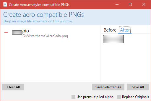

Today I found thoriumknight from 2011:
https://thoriumknight.deviantart.com/ar ... -262526394
has a great software converter, that is very easy to use.
For all those images in example aero.msstyles
What this means is if you like some button and try and use it in Classic Shell skin, the converted image will look correct brightness.
See how the 2nd column transparent button looks brighter in the below picture. It corrected the RGB layer, so it matches like on real Windows Vista/7 start menu. :)
I tried it it works.
I just had to force Windows 10 to run the program, as it thought it is harmful.
I checked it with Malwarebytes, and Windows Defender. No threats were found.

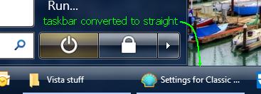

PostPosted: Sun Feb 11, 2018 5:58 pm
It makes the Vista taskbar on Classic Shell better looking
than using the unaltered one from MSstyles
Vista taskbar converted to straight.png [ 327 Bytes | Viewed 54222 times ]
Vista taskbar untouched premultiplied.png [ 378 Bytes | Viewed 54222 times ]
