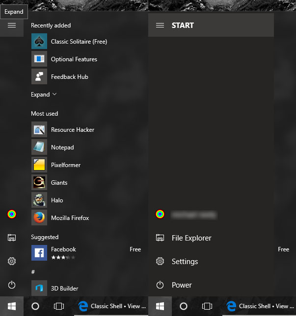

If emblems could have links, one could imitate the built in taskbar on side of new Win10 menu.
That use, could be more fitting. Have up to ten that user can change with custom image emblems, along with their links.
I had to laugh at the size of the user picture, when I first saw it.
Thought user picture on John Edward's skin was small. Win10 one even smaller. Need glasses. :geek:

That taskbar section, whatever it is called, does expand to show the user name,
just in case everybody's picture is too hard to discern. That pretty girl is not me, by the way. :)
I'm a guy who gets bored looking at oneself.
