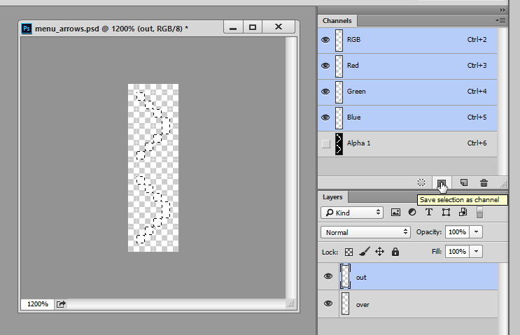

On a related note (useful info if someone is searching) to have 32-bit bitmaps actually use an alpha channel, you have to manually create it from a selection.
This can be done by selecting the areas you want to be opaque (Magic Wand or CTRL+click layers) then use the "Save selection as channel" button on the Channels palette.
