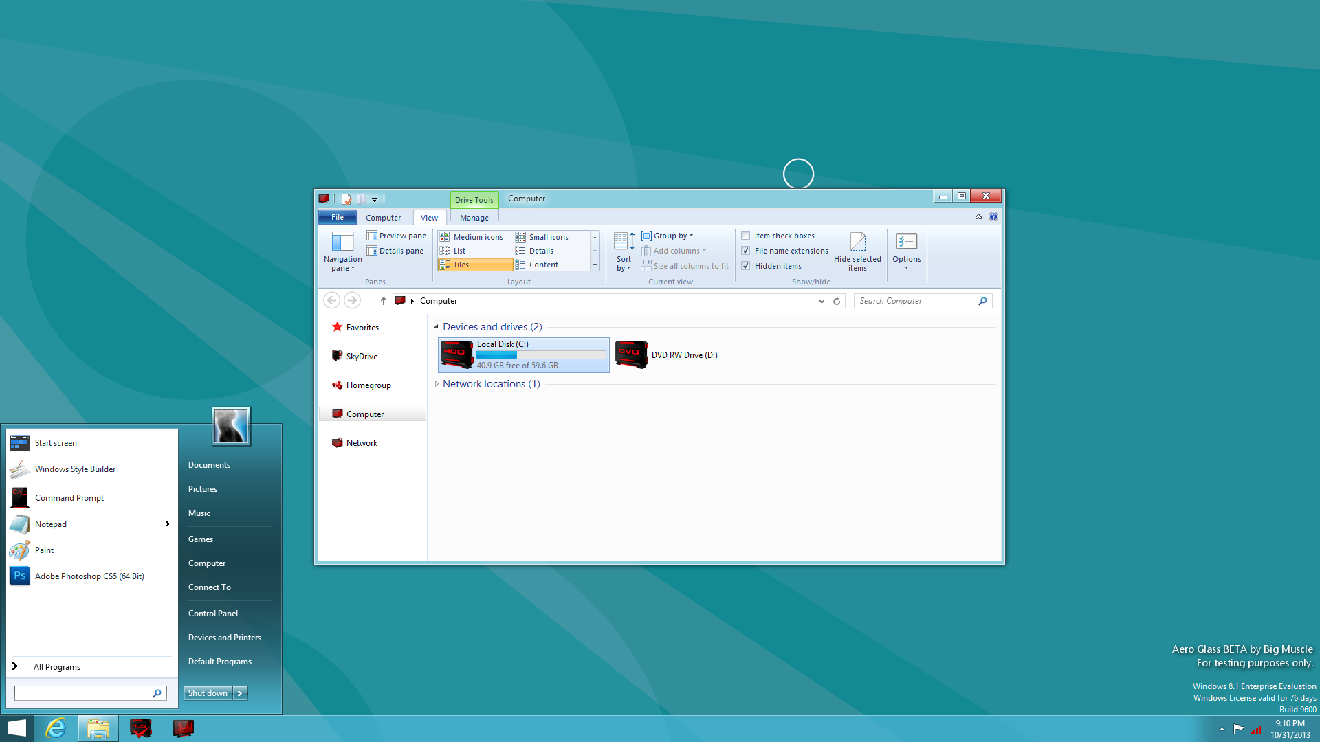

Can someone create a start menu skin similar to the one shown in the attachment (except with Windows 7 style arrows)?

PostPosted: Fri Jul 07, 2017 2:48 pm
Do you mean just to have square corners on menu, selectors, and user image frame? All you need to do is edit, and replace the bitmaps of an already made skin.
Example Windows Aero.skin7
Use free Pixelformer image editor. It should be easy. Use color picker, and pencil tool,
to copy and paste a color, to fill in the corner areas.
If you can't figure it out, I'll convert one for you later tonight.
PostPosted: Fri Jul 07, 2017 10:17 pm
Here. :)
Only made square corners. I did not flatten out the selector buttons.
I never tested on other systems, besides Win 10.
