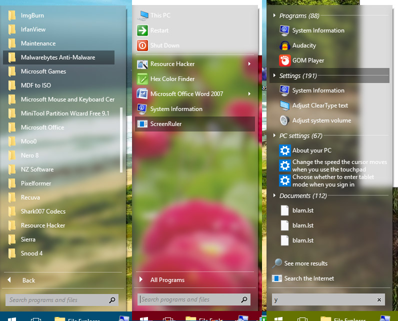

Hi. I started to edit the classic skin7 theme and got it to look like this: http://i.imgur.com/U1sRRP2.png. I've been trying to get the frosted glass effect like in the taskbar.
I should note that the bg color & scrollbar are adapted from the OS theme. I'd like to keep the scroll bar and only change the bg to white with opacity/blur effect.

Not sure what I'm looking at in the picture. :| I don't know what a classic skin7 theme is?
Is it a 7style menu with entries deleted in second column, with altered slices to cut off second column,
or is it full alpha transparency at zero, in second column?
Taskbar blur works differently than menu blur.
If you want to make second column with blur (fullglass), even without a glass mask, glass color will show at a low level.
Turning csm Glass opacity setting to 0 can help reduce glass color further.
It would require modification of 32 bit menu bitmap to make your desired rgb brightness/alpha transparency

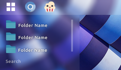

Edit: I attached a mockup. So basically just mimic the glass effect on the taskbar as the startmenu background.

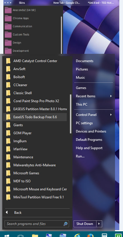

After logging off last night,
I played around with Win 8, 7 style skin.
I partially modded some parts to see how a scrollbar could work,
put second column as 128 alpha and dark grey brightness.
I put your picture behind menu to see what it looked like on Win 10.
(Win7 os has smaller blur radius)
I set small icons at 24 size.
Here is the screenshot.
It would be nice if you had a real screenshot, or your working on, skin file.

If it's the left you want frosty blur, I would not modify the menu bitmap below 64 alpha,
because from past experience, transparent parts of scroll don't work properly.
Hmm, if what you are using is really "Classic Skin.skin7", there are no menu bitmaps!
I have to go. Will get back to this site in evening. Bye. :)

Thanks! The frosty blur is not only for the sidebar but for the whole menu. I didn't need the 2nd column bec I have the shutdown button moved to the system tray like in linux.
That sidebar is perfect but instead of dark grey, can it be white? or offwhite?

I looked at your new mockup picture. Looks very nice.
It will be hard to duplicate that.
The whites are still close to white. Very transparent.
Unless you are on Win7 using a faint dark text glow in a theme,and heavy fonts,
it's going to be hard to see white text on, near white backgrounds.

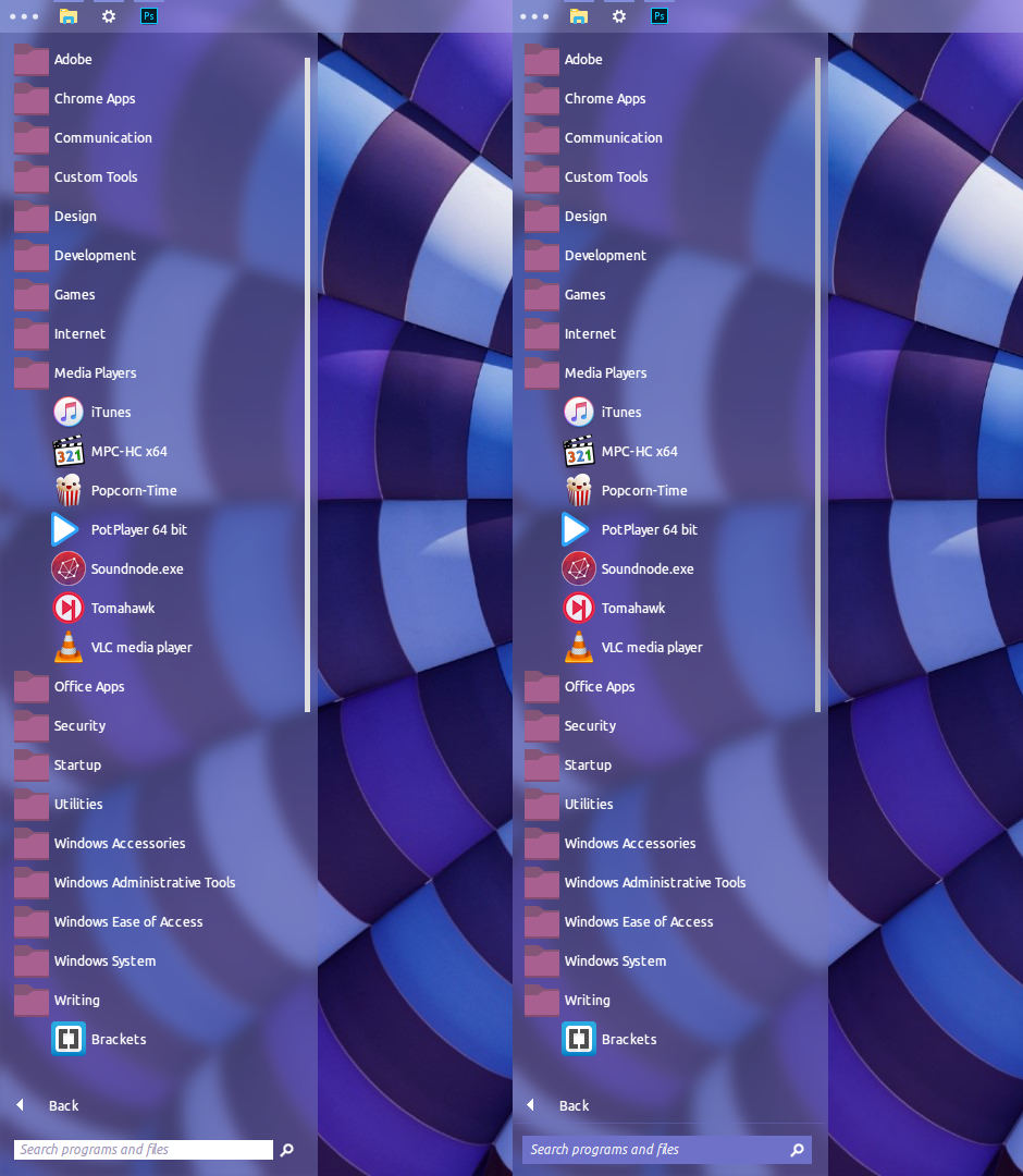

Here is picture of it. I have color masks turned off, with small icons.
CSM settings have 24 sized small icons. Glass opacity at 0. I never did anything with the submenus.
Never used the a menu like this. I got scared of no 2nd column. I had to put a few links in.
It's odd having a search column so narrow.

I decided to abandon what I made so far, because if what you really want is near white,
then the best skin is Ivo's Windows 8 skin7.
It is stuck on transparency 181/255. What I did was make everything same color,
and put in your thin scrollbar. That scrollbar created speedbumps, hurdles, and moats filled with sewage.
I had to put an option in case someone wants to use skin without menu glass, like on Windows 8.
Make sure to set button correctly, or you will see scrollbar's unmentionables.
Settings on Windows 10
So either put CSM "Glass opacity" setting at 50, or 0. In my opinion 0 is better.
Turn on "Overide glass color" option, and set up a white color like 220
If you are on Windows 7 there are other menu glass settings to use.
If you want to edit the skin bitmaps to lower transparency, everything has to match,
like scrollbar parts, and programs background. The thin scroll bar creates the biggest challenges.
Anyway I think I'm done. :) It's not going to look like the picture above.

Omg they look great. I really like the first one. Thank you so much for making the scrollbar. It was the right call to grey it up a bit because when I was playing with tenified the menu doesn't work with white backgrounds. I chose to use Smoky instead and decided to add a color tint to match my wallpaper. I'm very happy with the transparency so it was fine. I did try to edit the bmps of the scroll/bar search but after a couple of trial and errors I retreated to using the original version.
I edited Smoky's search bar to white (+bmp) and another one to match the glass opacity accent color. It won't work with white accents tho.
The settings I used was a purple tint with a +25 glass opacity. I actually liked it more than just white.
I attached screenshots, my settings, edited skins & start button if anyone wants to replicate them.
