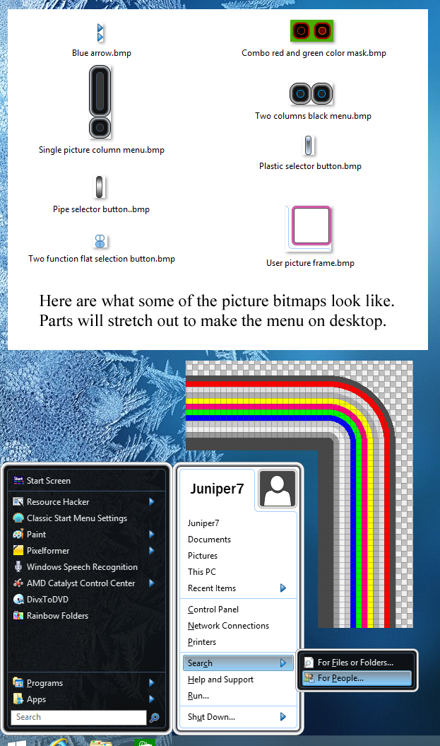

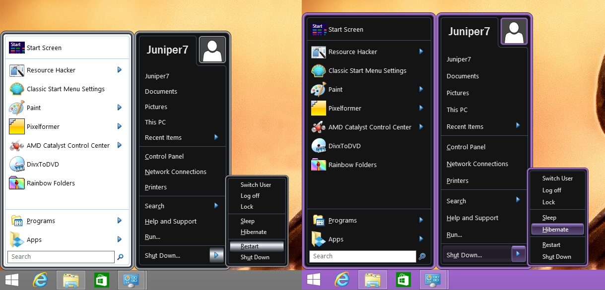

Part 1 of 3 BlackenLite revB
Update. Now revB "Center user name" option is on permanently.
This test bed, or double beds was made for Win8.1. Works on Win7, as I put some internal color presets to offset Win7 wild color.
Tried with CSM 4.1.0
After downloading file, paste in skins folder. Usually C:\Program Files\Classic Shell\Skins
Exit CSM, restart CSM, and go to "Start Menu Style" tab.
Pick Classic or Classic two columns.
Pick "BlackenLite" in Skin tab.
Incentives
- Metal pipe signage on way to work.
-Had to see what a black and white, verses white and black column menu looks like.
-To challenge myself, and the limits of skinning, without much artistic, or scripting knowledge.
-Had to be different. So made column tint darker than normal.
My favorites
- Metal Grey edge variation with Pipe button.
- Sky Blue variation with Rubber tire button. My new word, I DYNAMIZED it.
- I can live more with the Tire edge, Rubber Tire, Blue Regular combination.
-Mylar plastic button on white. Believe it or not, this was made from a vertical sliver of Ivos.
Made it brighter, but the white reflection interfered with the white text. So I pushed it very high.
Not good enough to be called glass, so I call it plastic.
The goofy
- Not a big fan of transparent menus. It gives some texture, but to me, looks ugly most of the time.
Added an option to turn it off.
- The pipe button in submenu looks so 3d real. Touch it!
- The blue inverted button was from my goofy mistake, having regular blue on opposite column.
Made a screen shot to put back on white column. Tends to look better with black column though.
Guess due to contrast punch.
- Oh yeah. The single classic with name or picture is bizarre. No idea why I made it like that.
Problems
- This skin got way too big. For each addition, ten times the problems of making it all work together.
Modifying and saving file hundreds of times meant something is going to go wrong at some point.
It was me, overwriting the file. So I redid breaking it up into 3 parts.
Probably going to be my last big skin. I will go back to simple one offs in future:)
I don't know if there are mistakes in the scripting or not,
as I never checked every possible combination of feature options.
Let me clarify that. I know there are protocol mistakes, but I believe I fixed most of the visible ones.
-Still has radio option dots not showing up, or showing more than one, at first time use. No idea how to fix.
-I will gladly fix any of my buggy mistakes, when you find them, as long as I have time:)
- One more thing. Disable menu shadow setting in CSM options, to get of line at bottom corner.
Bye.
BlackenLite revB.skin [1.14 MiB]
Downloaded 3662 times

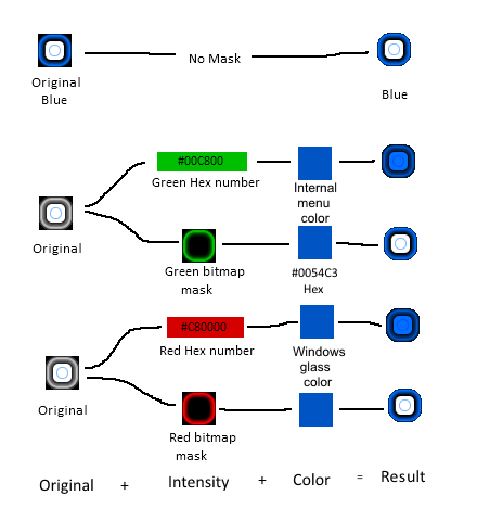

PostPosted: Fri Jan 02, 2015 8:27 pm
Hello Pipalou50
It's a bit hard to tell what's going on behind the fuzzed up picture:)
Is it BlackenLite or your own masterpiece skin?
It looks like the button color is controlled by the Windows System glass color.
That can be adjusted by right clicking on empty part of desktop,
and getting to Personalization\Color and Appearance. Adjust the sliders to change the color.
CSM overide glass color option can alter color as well.
I think you know that already, though.
The button may have a real picture color, that does not change. You can use Resource Hacker to save a copy of the bitmap picture,
edit it in say, Adobe photoshop, by adjusting the hue to your taste, saving it as 32 bit bitmap, and replacing original one with new one in resource hacker.
The button bitmap could be a neutral black, grey, or even white bitmap, but have a green hexnumber, or green bitmap mask,
for intensity level, referenced to the internal menu hex color.
That hex color text can be changed inside the skin. It looks like this "Main_background=#AEA661" or "Submenu_background=#AEA661"
If it is referenced to a red hex number, or red bitmap mask, for intensity, it uses the System glass color as first explanation. Only the saturation level can be adjusted.
I hope the french translation does not make confusion.
Here is a simple picture of how the masks work.
I'm finding out it is more complicated than picture, as the alpha layer of original bitmap plays a role.
Bye.

juniper7 wrote:
Does the left side always have to be white?
Sorry to butt in, but...
No, it doesn't have to be white.
(That's my new Windows Lunaero skin7, hastily edited to feature...black in the left column, for the sole purpose of demonstrating that)
