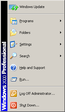

 Post subject: Re: Caption images
PostPosted: Sun Feb 01, 2015 3:50 pm
I dont think there is a way to determine which OS is being used by a skin.. so its 1 caption image for all OS's and the text is overlaid by classic shell itself
PostPosted: Sun Feb 01, 2015 5:05 pm
Joined: Fri Apr 18, 2014 12:43 pm
Posts: 68
Actually, I'm making a skin that will let you choose which OS version you want to have displayed. So if you want the menu to say 'Windows 2000 Professional' you'll have the option to do that and it will display the original bitmap from that OS. So it wouldn't automatically determine which OS you're using, it will just give you the option to have it display the original caption from whichever version of Windows the user chooses.
But I'm also keeping the option to use a custom caption like the default classic skin.
Here's an example of what it would look like (Keep in mind I'm not using Windows 2000; I'm using Windows 8.1 with classic shell):
