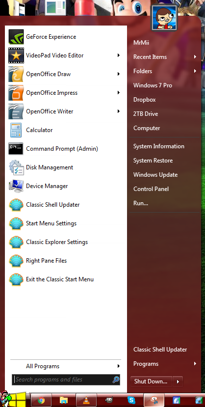

I have a skin (7 Style) that I really like, called Aero Flat, that although I like how it's glass in the right column, I really would want the left column to be glass as well, to ditch the opaque white background. My question is, is that possible to do, and if so, is it like, okay? Would modifying it be considered stealing the skin? (the search bar is black because of my theme and not part of the skin)
The skin is from: viewtopic.php?f=17&t=1192 by mpu

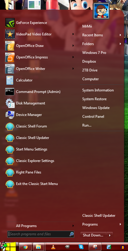

I think I might need some pointers xD I tried to edit a bitmap and the result was... a total failure xD Here's what I tried to do with bitmap 8, what RH showed when I replaced it, and then my resulting skin xD When I replaced it in RH, was I supposed to cut out the white part in the top corner or just in the middle? And I did export it as a 32 bit BMP. Apparently I wasn't listening about the merged RGBAlpha thing, but I don't know which bitmap to edit, if not more than one. Ugh, this is gonna be a long day... But I'm not giving up yet. I WILL make this skin full glass or my name's not Smitty-werben-jangerman-jenson! And it's not. Is making skins supposed to be difficult? No offense but it seems like it...

I implemented the bitmaps and script changes, and to my surprise, it worked xD Thanks a million! I also changed the main menu text from black to white. However, most fonts don't work with the skins it seems, like Super Mario 256 Bold, but that was just to test it. :D
When referring to your modded bitmap 1, does the black corner define alpha? Because I saw no alpha layer in my editor. Just curious.
And this is just greed talking, but does increasing or decreasing blur (in this case, increasing) have to do with bitmaps or the script? And uh, is there a way to add an open animation that isn't a fade in? Like a slide (or however you describe it) similar to 10's integrated Start? I'm only asking because the classic and classic w/ two columns styles have the ability for a fade in. I think I'm being just a tad bit greedy here... I apologize... :geek: If it can't be done, I can go without it.

and is that the way you want it?
What happens if you change the text at line 275 from:
Search_background_mask=24
to
Search_background_mask=0
Does it turn white again?
PostPosted: Mon Feb 29, 2016 4:02 pm
Joined: Mon Jan 18, 2016 10:30 pm
Posts: 19
The theme, "Mr GRiM's Dark7 Ultimate Theme for Windows 7" makes many different elements of the UI dark, including the search bar. (And a handful of third party programs) When I changed the background mask to 0 in AeroFlat FullGlass, the outer edge of the search bar was white, but the text box remained black. Personally I have no preference for either a black or white search bar, but I do like the black one better. However, when it comes to searching, I usually use the search bar within File Explorer.
PostPosted: Tue Mar 01, 2016 12:42 am
Interesting.
I kind of thought it would turn all white, not half.
Mr GRiM must overide at a high level. I like it all black too, in this case.
Thank you for the experiment.
