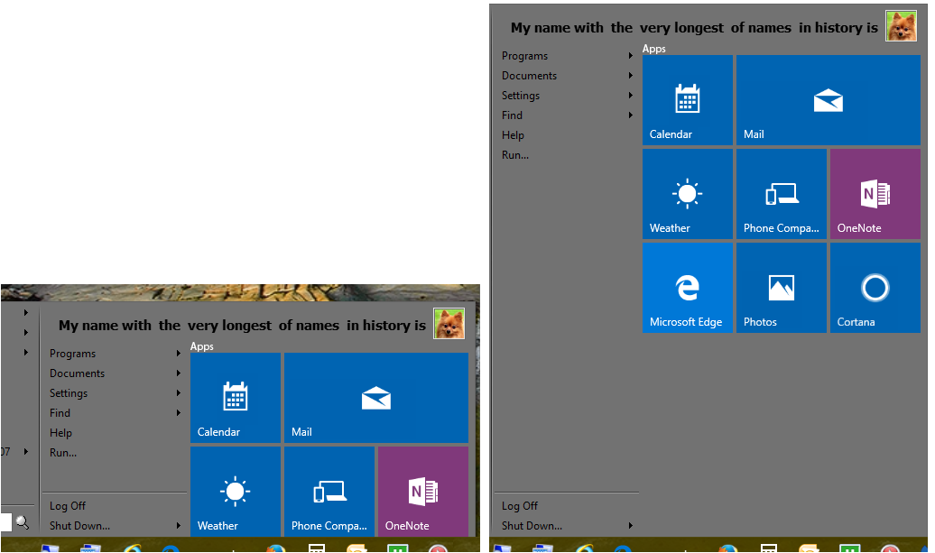

Here is a picture of a couple parts.
It looks like someone opened the window, with text floating in the night air.
Hurry up, and close the window, the text are getting in.
One more.
I don't do windows, I only do tiles. :)
They are burnt in, or embedded into bitmap.
That's a thought. A simpler glass color version could be made to work on Win 7.
Will leave for others, maybe you. :)

I tried what I said.
It worked at first, but if I added 25 recent programs, it got in way again.:(
What I did was, change the text "bottom" to "top".
So when there are lots of entries in first column, the emblems stay rigid at top, with space below instead.
You could keep adding more emblems, to fill the blank space, so it looks like real Win 10.
Or you could add something else like um, oh never mind. Don't want to hear more commandments. :lol:
I see there are two emblems in skin not used.
[(USER_NAME OR USER_PICTURE) AND NOICONS AND SMALL_ICONS AND TWO_COLUMNS]
Main_emblem1=53
Main_emblem1_padding=12,41,7,12
Main_emblem1_alignH=right
Main_emblem1_alignV=top
Main_emblem2=55
Main_emblem2_padding=12,160,7,0
Main_emblem2_alignH=right
Main_emblem2_alignV=top
Main_emblem3=54
Main_emblem3_padding=12,264,7,0
Main_emblem3_alignH=right
Main_emblem3_alignV=top

Hi, I tried doing [NOICONS AND SMALL_ICONS AND (USER_PICTURE OR USER_NAME)]
User_frame_position=10,6
User_name_position=10,10,-54,40
And then the text for the emblems. I don't have to specify the user_frame and user_name then?
The adding more emblems to new space with lots of recent programs sounds good. I'm not sure how to make classic shell add more emblems if there is more space. Like 10 recent programs = 4 emblems, 20 recent programs = 5 emblems.
I did have the emblems aligned by the top, but I didn't want them to move when more recent programs got added, so I made it aligned to the bottom.
How do I make the space that has 'programs, documents, settings, find, help, and run' to stay at the bottom? It looks like it is pushed up to the top with many recent programs, leaving a big space between 'run' and 'logoff'.

PostPosted: Sun Jan 15, 2017 10:21 am
I was away for a few days, I have to make it up with lots of text, with bad spelling, and grammer included.
Hi redblade8.
I don't think the user picture info needs to be added again, unless it is different.
Hmm. Guess there is something different.
The User_frame_position is missing the "-", so it puts the picture on left side.
Yes that could work too.
Would have to increase top padding on left column of Classic 2 style, and bring the name over too.
Unless it was a mistake?
I made a big booboo on my skin. A couple days ago, I started to play around with your skin.
I was tired, day dreaming, on autopilot mode. When I saved mod of your skin, I wasn't looking where it saved it.
It overwrote my skin, coz program remembered the path from before. I was so lucky. I had made a backup an hour before.
It's very dangerous switching back and forth between different modded skins.
Back to your skin. If you still want the user picture on right, with extended emblems,
anything larger than menu will be cut off like Win 10 real menu.
You could always add an emblem mask for the emblems so emblems get cut a small distance before taskbar, like a border.

I'm not on Win 10 right now to make a screen shot of how the tiles disappear at bottom of real menu, when its scrollbar is moved.
Only you know what you want on the skin, regarding the amount of padding.

Oh. I think I got you now. The tiles disappear when you scroll.
Only a bit of padding on the top. I'll have to try and see.

The way I see about glass color is, white is included, Win10/8 don't use white in startscreen/startmenu color tables.
One of the pictures explains one of the types of padding, I was talking about earlier.
The other picture I made, then noticed your reply. Uploaded anyway.
