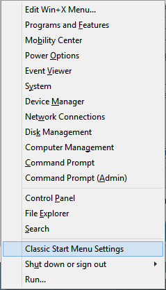

You can edit the Win+X menu yourself using Win+X Menu Editor: http://winaero.com/comment.php?comment.news.30 . Add a shortcut to open Classic Shell's settings if you want. The command line to use is:
"C:\Program Files\Classic Shell\ClassicStartMenu.exe" -settings
