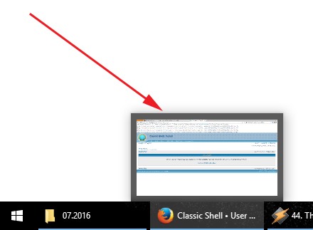

-If I hover over a program in the taskbar, it brings up the little preview window (see attached photo). The only problem is that it doesn't go away when I move the mouse away and only goes away if I click within the little preview window.

File comment: Hover-over preview window

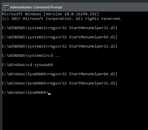

Did anyone ever get Right Click / Context Menu in CSM working once it broke? I've had (the latest) installed on MULTIPLE Win 10 Pro 64 bit build 1709 installations without a problem. But now I can't get right click to work for the life of me!!!
Please if anyone has any advice!!! I've tried registering or re-registering StartMenuHelper64.dll (and 32 as well) both in System32 and SysWOW64. I didn't see any dev post that suggested only one is needed, or in which location, or what?? But even with doing this, and rebooting, and force-restarting explorer, I'm not having any luck.
Anyone get this fixed once broken?? Or am I doing something in the wrong order??
Note: My only theory is that one must install Classic Shell BEFORE the major feature upgrade in order for it to work? This is the only time I've installed it AFTER and now it's broken... I cannot live without CSM
