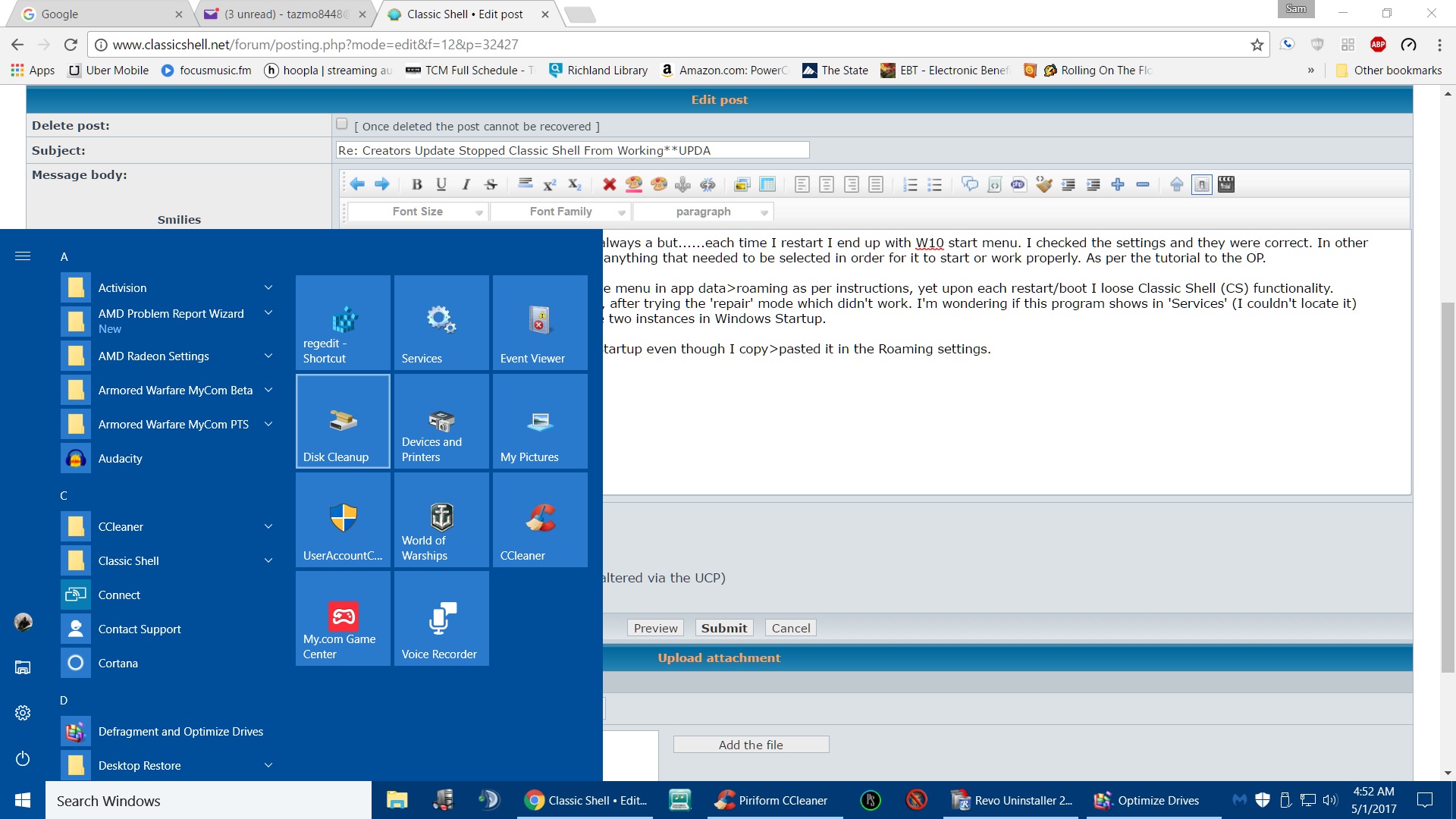

I just received the Creators Privacy Update and it stopped Classic Shell from working. Now when I click on the START button it takes me to the regular Windows 10 UI. I tried installing 4.3.0 again to no avail. As with the anniversary update it seems this 'Creators' update is reeking havoc with CS.
Please advise.

PostPosted: Sun Apr 30, 2017 12:06 pm
Open Classic Start Menu Settings using Windows Explorer (File Explorer) by going to C:\Program Files\Classic Shell\Start Menu Settings.
Check "Show all settings" at the top.
On the Controls tab, make sure that "Left Click opens" and "Windows Key opens" are both set to "Classic Start Menu".
Next go to General Behavior tab and make sure "Start automatically for this user" is enabled.

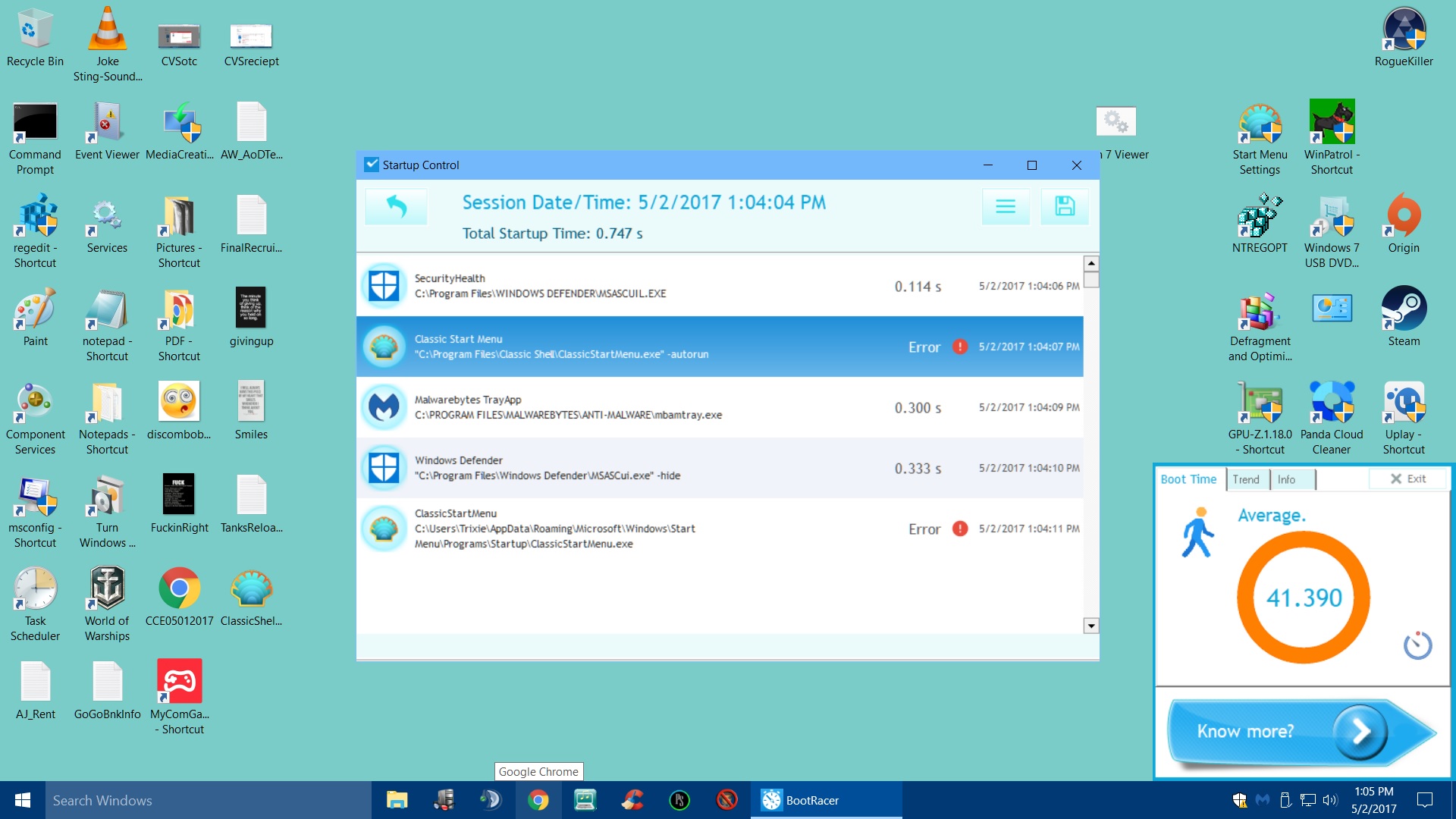

Well I thought I had this whipped but....always a but......each time I restart I end up with W10 start menu. I checked the settings and they were correct. In other words I did not have to change or select anything that needed to be selected in order for it to start or work properly. As per the tutorial to the OP.
I also added the CS Start Menu.exe to the menu in app data>roaming as per instructions, yet upon each restart/boot I loose Classic Shell (CS) functionality.
As stated in the OP I even reinstalled CS, after trying the 'repair' mode which didn't work. I'm wondering if this program shows in 'Services' (I couldn't locate it) CCleaner shows it in startup an there are two instances in Windows Startup.
For some reason CS is not launching in Startup even though I copy>pasted it in the Roaming settings.
Please Advise.

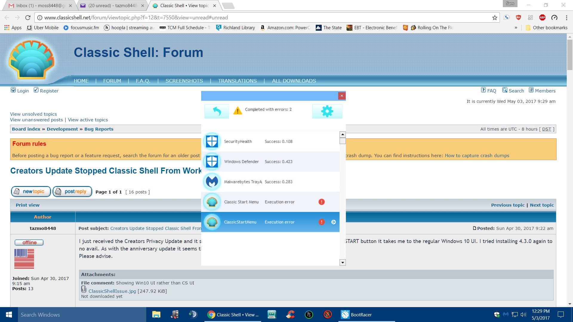

PostPosted: Tue May 02, 2017 10:28 am
Posts: 21
Where do I find the 'log' that is created to send.
I am also attaching a screenshot using BooTracer that shows on startup two instances of CS not starting (error message)

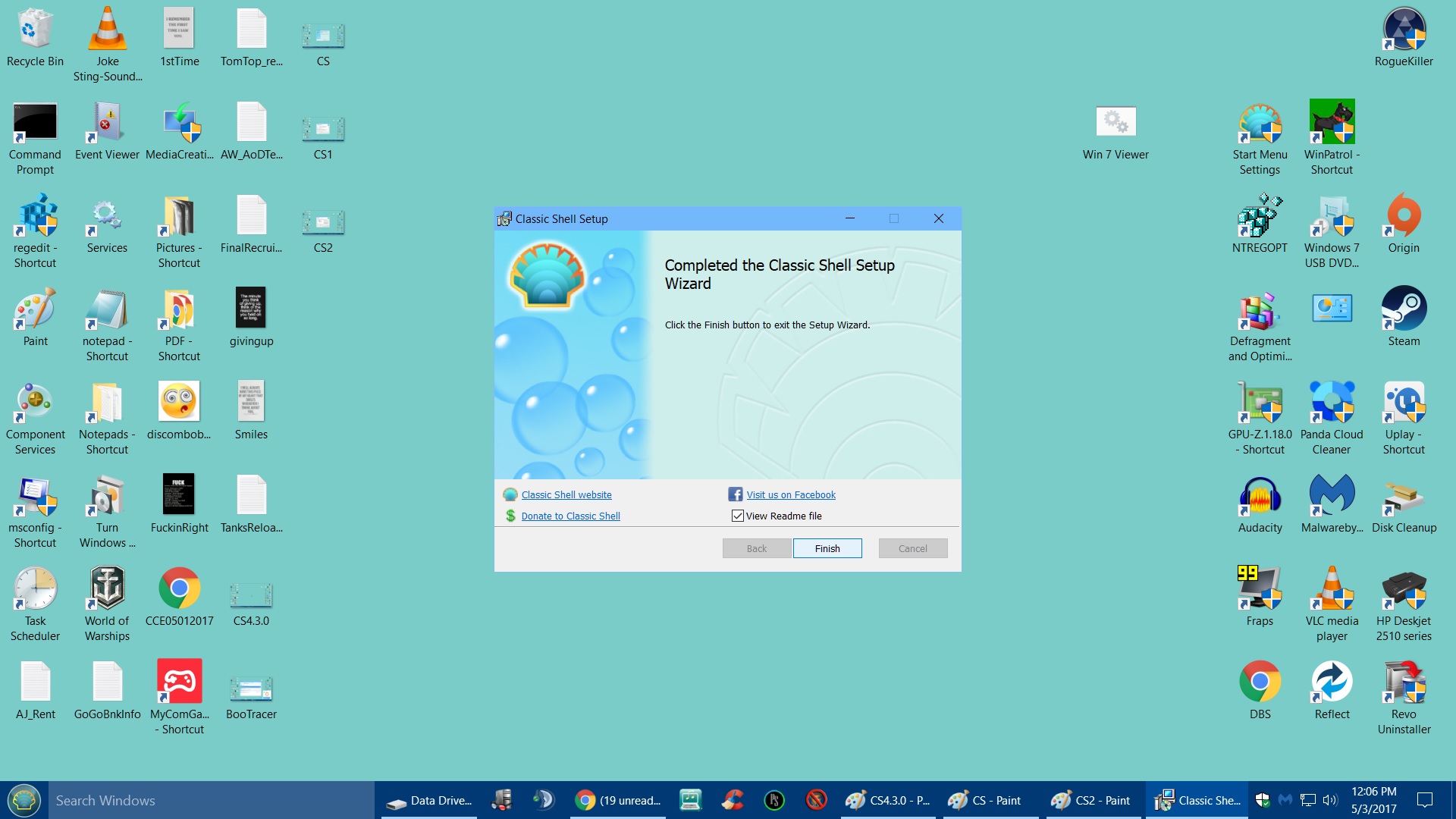

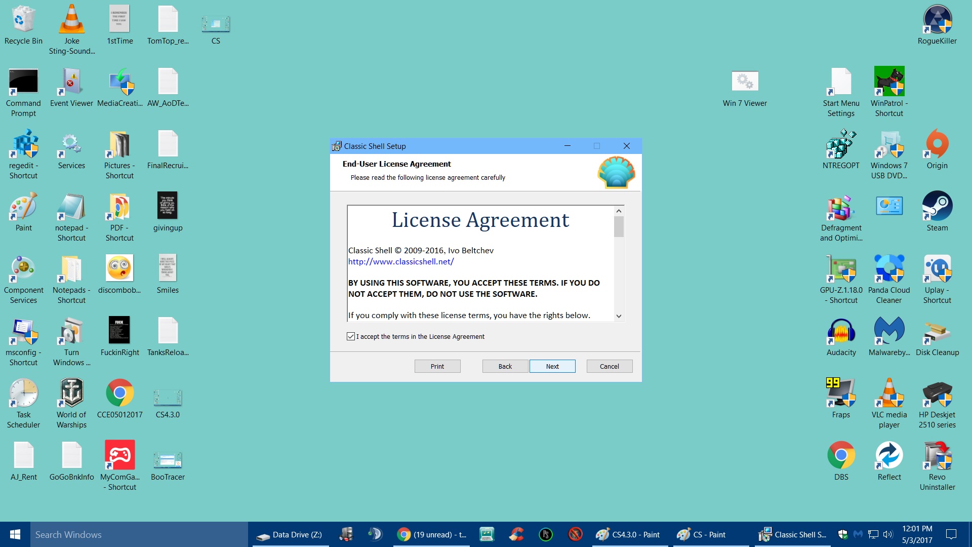

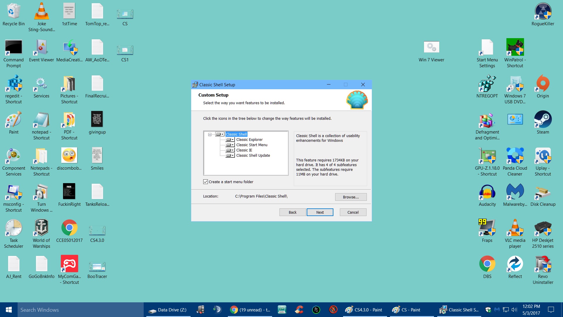

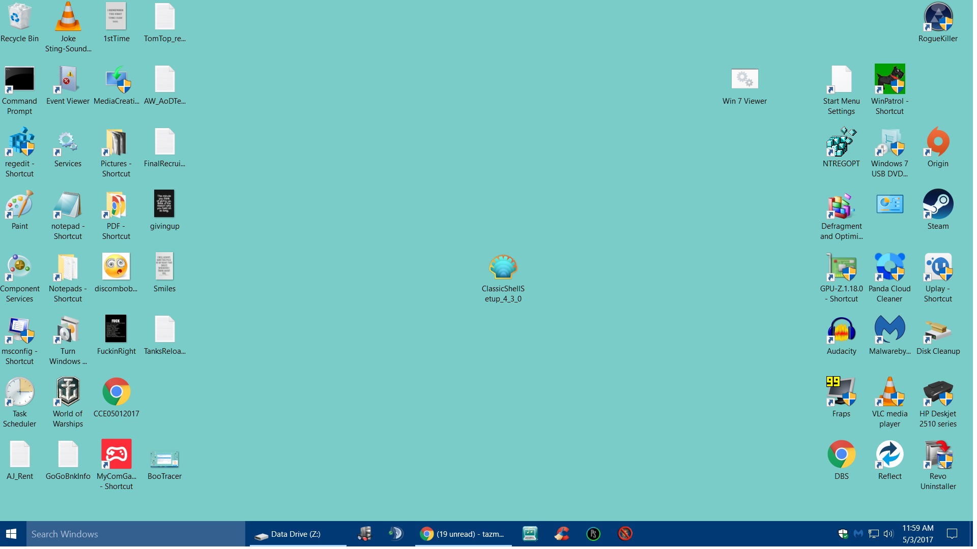

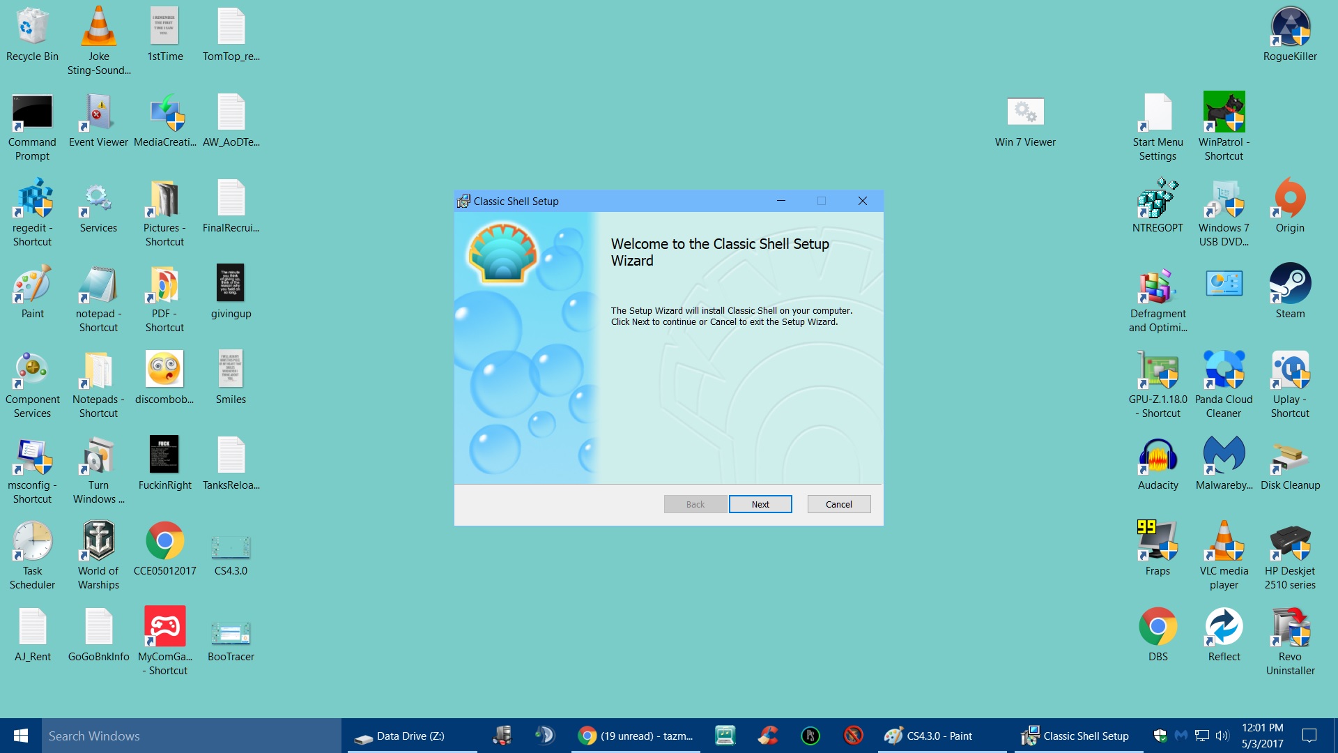

PostPosted: Wed May 03, 2017 9:12 am
Posts: 21
The one I have (and I will include screenshots) of the step by step that I see installing the utility. I uninstalled it an this is the sequence of re-installing.
Two more to follow.
Note:- I got the utility from the link you provided and it matched one I had gotten earlier. (4.3.0)
File comment: Run
CS1.jpg [317.81 KiB]
File comment: OPen
CS.jpg [286.53 KiB]
File comment: CS Program
CS4.3.0.jpg [235.08 KiB]

PostPosted: Wed May 03, 2017 9:13 am
Posts: 21
Here are the other two screens.
Note: Did not see anything that indicated log file.
The sequence is:
CS4.3.0
CS
CS1
CS2
CS3
File comment: Finish Screen
CS3.jpg [297.44 KiB]
File comment: cont'd
CS2.jpg [313.12 KiB]
PostPosted: Wed May 03, 2017 9:15 am
You are running the installer. You need to download the Classic Shell Utility - further down on the download page.
