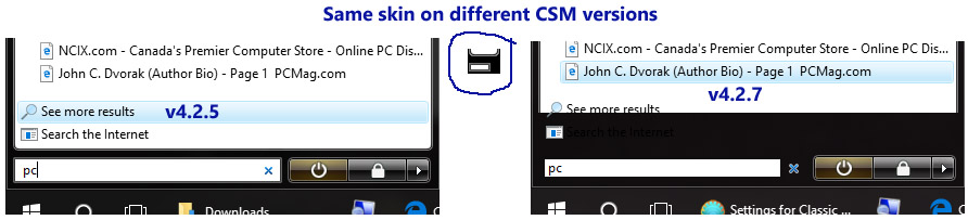

Hello.
Using version 4.2.7 on standard Win 10.
When using an additional bitmap for
"Search_background_search" in Win 7 style.
Bitmap does not show up on menu, any more.
Was there working on v4.2.5
example skin:
download/file.php?id=3210
Related but not a bug.
That Vista skin I helped with, might show up a small gap between the search bitmap on v4.2.5
When I have time, I will need to alter the padding to a higher number say 125, to fill in gap,
or copy text from Metallic skin.

Can you show me a screenshot how it looks for you and how it is supposed to look?
PostPosted: Tue Jul 12, 2016 11:11 am
Sure. Here is visual.
By the way reg and jump menu views work fine on both versions.
Just the search view search bitmap hidden, on 4.2.7
PostPosted: Tue Jul 12, 2016 11:23 am
I might add.
At the time, we could only get the Vista look by using a different bitmap for each reg, jump, search view.
That's why this issue will not show up on roughly all the rest of skins, that use one bitmap for all views.
PostPosted: Mon Jul 25, 2016 9:32 pm
I found the problem. The setting Search_background_search was incorrectly parsed.
It will be fixed in the next version.
