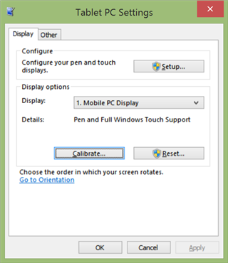

I have observed that if you go to the Control Panel -> Tablet PC Settings -> Calibrate..., it breaks certain parts of the Modern UI such as the Charms Bar and other Edge UI. It might be breaking the Start button too. Once you press Reset and choose not to Calibrate, it works well.
