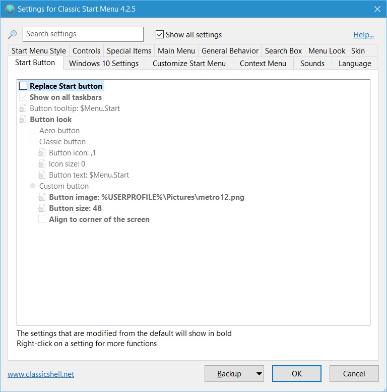

Running with the options in my screenshot below produces no scrolling problems in Firefox. However, when I check 'Replace Start button' I get choppy scrolling under certain circumstances. I can choose any button look to get the choppiness. I also notice that the Start Menu icon is smaller when the 'Replace Start button' option is unchecked than the buttons with the other options.
Here's one scenario that produces choppiness when scrolling.
1. Check 'Replace Start button' and choose aero button in CS settings.
2. Have the Windows Taskbar auto hidden.
3. Start Firefox and maximize the Window.
4. Move pointer so as to display the Taskbar.
From this point on scrolling will be choppy. Most noticeable when scrolling slowly. There are other situations but they all disappear when I don't Replace the Start Button.
