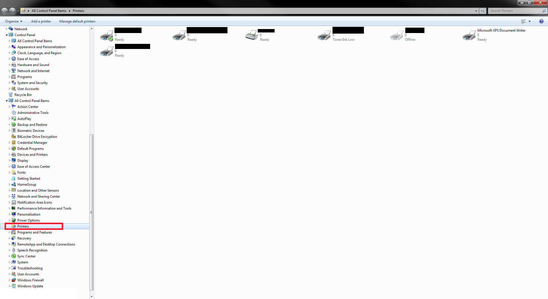

I've added the Settings->Printers menu to Classic Shell. I have a network printer installed from our File Server on my workstation.

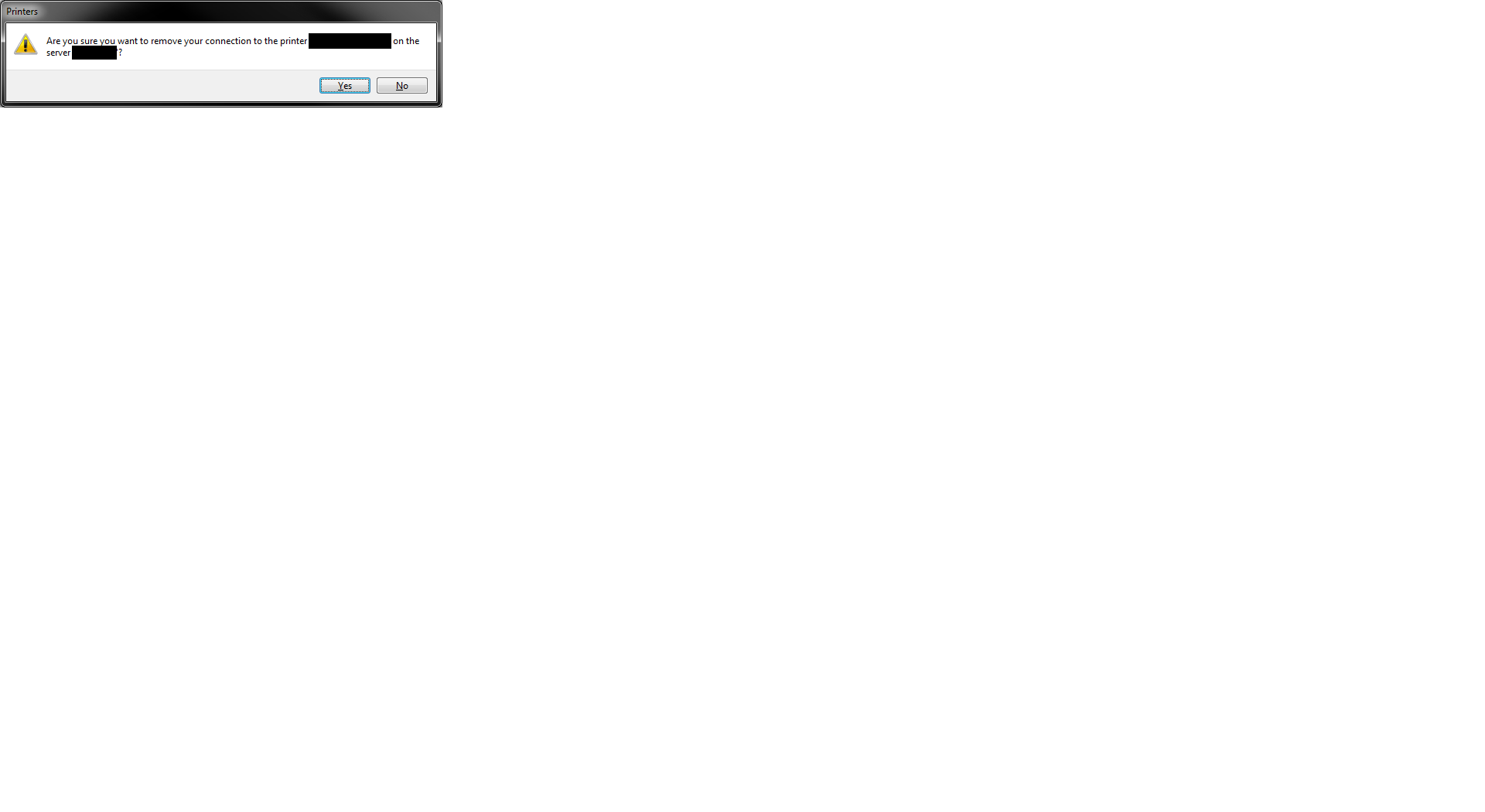

If I go to Settings->Printers and right-click "open" and open the Printers window, I can see all my printers. If I right-click->Delete a network printer (See file A.png in attachments), I'm prompted with B.png (See attachments). It proposes to delete the printer from the server itself and if I click it, then it does delete the printer on the server for all users. (I'm domain admin).

This is only a difference in how the classic Printers folder operates vs how Devices and Printers works. Both folders are part of Windows, even the old Printers folder which you access from the Classic Shell Start Menu. Classic Shell only lets you access the old Printers folder, it isn't really part of Classic Shell. Windows tries it best to hide the old Printers folder and makes you use Devices and Printers which has some functions missing that only the old Printers folder had.
Regardless of whether Classic Shell is installed, you can open the classic Printers folder from the Run (Win+R) dialog too by typing:
shell:PrintersFolder
PostPosted: Wed Aug 12, 2015 10:26 am
