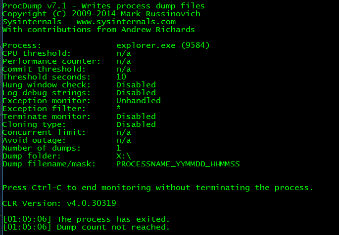

It appears you are hitting a crash. Use the instructions at the top of this forum to capture a crash dump and upload it here.

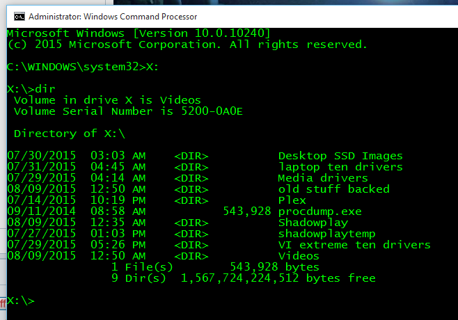

It won't make a dump as the everything reloads I guess, the dump should be in the area I put the tool right?
EDIT: added another pic showing what it is telling as it has no dumps.
