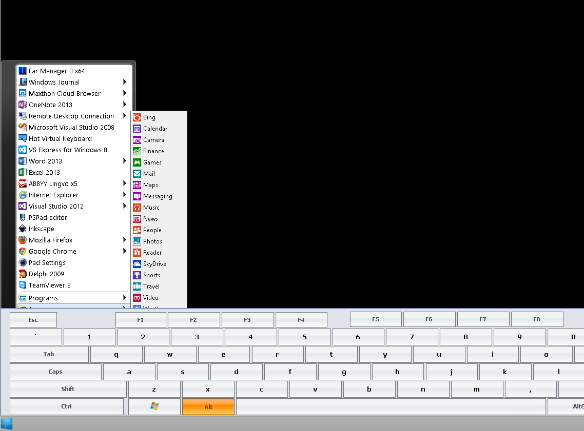

Expected befavior is shown on screenshot which is attached below.
Menu should appear straight above the virtual keyboard: bottom coordinate of menu should be less than rcWork.bottom coordinate, on appropriate screen.
That way works original windows Start menu Windows 7/XP: it does not overlap nonworking part of the screen (does not overlap screen parts which are excluded by something that adjust results of GetMonitorInfo() rcWork).

No, they do not overlap keyboard. Keyborard is top-most window, and that is another issue (Classic Menu, as I presume, should be set as TopMost window and take priority over other windows).
Both menu and tooltips (tooltip over Inkscape in screenshot above) - all are hidden by the Virtual Keyboard, as you can see.
Also please a note, that sending the Virtual keyboard back (below Menu) is not an option - because I still need keyboard to type something in Menu's Search window - having keyboard top-most window is a reasonable choice there, as far as the keyboard declares itself as excluded part of the screen.

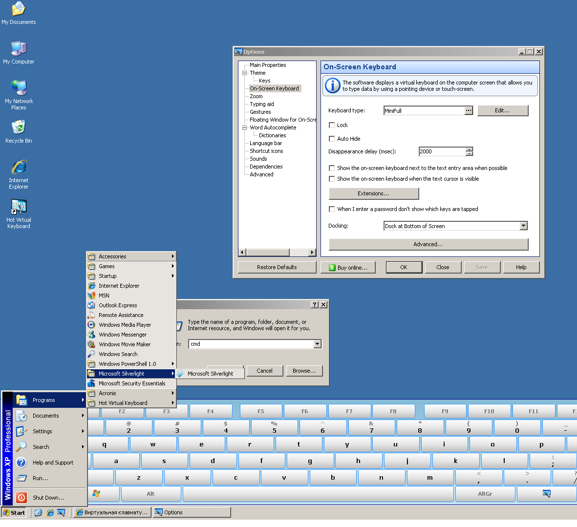

Here the screenshot of Windows XP. I mislead you a bit, Start Menu overlap Virtual Keyboard there (see Docking Option in Virtual Keyboard settings, that is non-default).
It was a bit unexpected, menu supposed to appead above virtual keyboard, but that's fine because Windows XP does not have Search option in menu,
while Run dialog appears straight above the keyboard, as expected.

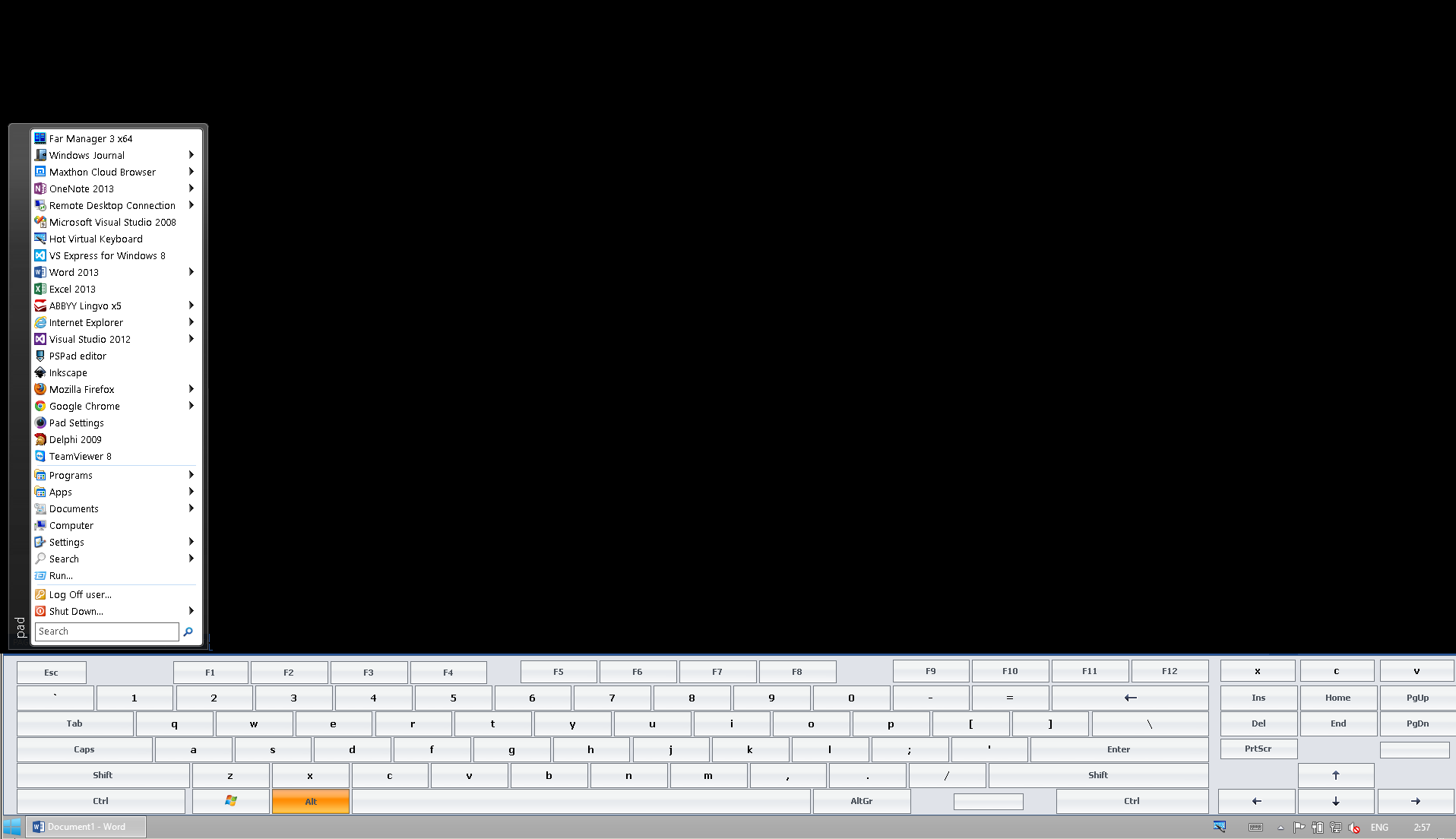

Here the Windows 7 one. It looks like I mislead you again - config from scratch shows that Windows 7 still does not allow to type me in Search box using the virtual keyboard.
I solved that somehow, I can't remember how exactly, but Windows 7 showed me Menu straight above the keyboard.
I can't reproduce that right now, I migrated by Tablet to Windows 8 completely, but expected behavior is just like I show in picture #2 - Menu should appear straight above the keyboard.
