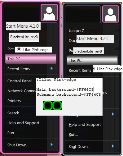

Something odd happening with one or more skins with new update 4.2.1
The internal background menu color does not work all the time.
example: BlackenLite revB / Lilac Pink- edge missing reference to pink?
My apologies' if I missed a new setting somewhere.

Hi again.
OK.
Hope this has more info. :)
I noticed the green mask is not showing the background color on this handmade skin, after upgrading to 4.2.1
viewtopic.php?f=17&t=4076
BlackenLite revB
In this case, the pink edge is missing, only showing the default skin.
Any option using green mask not working. Red mask ok.
I even changed version text in skin from 2 to 3.
No difference.
Looks to be same issue on other skins I made.

Hi.
Is there some text, one can put in skins that were made for earlier CSM versions,
to enable the green menu mask internal menu color?
Was hoping the Beta version 4.2.2 would solve it. Still the same.
Here are a couple of other skin links, that don't work properly.
Limbo Skin
viewtopic.php?f=17&t=376&hilit=limbo
Dark Cloud
viewtopic.php?f=17&t=1950

OK, I found the problem. It will be fixed in the next version.
PostPosted: Sun Jul 26, 2015 10:33 pm
Ivo has fixed this in Classic Shell 4.2.3 release candidate so the green mask bitmap in skins works again. :)
