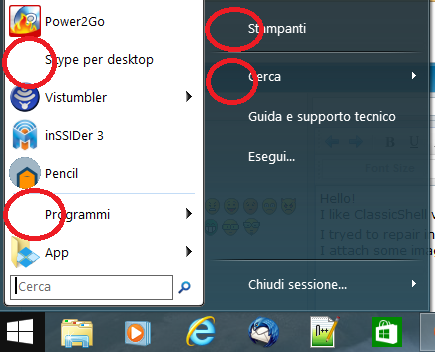

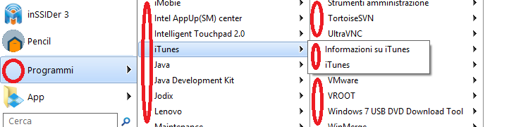

Hello!
I like ClassicShell very much, but with the last Windows 8.1 update, some icons in the menu are disapears!
I tryed to repair installation without success, so I try to unistall and reinstall, but still no success :cry: .
I attached some shots of the problem.
Andrea

This procedure has resolved the issue:
Exit the start menu (right-click on the start button, select Exit)
Go to the %APPDATA%\ClassicShell folder and delete the DataCache.db file.
Log out and log in.
Thanks!
