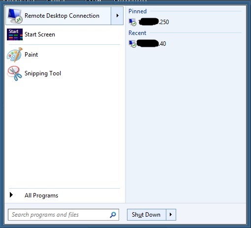

first of all I want to say that I've been using ClassicShell for many months now and so far everything has been great. The only problem I've got is that two-three months ago the pin/unpin option in the jumplist section stopped working. As shown in the attached file, I cannot unpin the top shortcut (the one that ends in 250) and also cannot pin the bottom shortcut. The pin icon on the side is not responding and the options when I left-click and choose pin or unpin are not responding also.

I had the exact same issue. Here is my solution:
  1. Pin the item to the taskbar by right clicking and selecting "Pin to Taskbar".
  2. Edit the jumplist from the taskbar item.
  3. Remove the item from the taskbar by right clicking the taskbar icon and choosing "Unpin this program from taskbar".
I have been working opn this issue for some time now. I looked at all of the settings in Classic Start and could not find any remedy. Finally, I tried the steps above out of desperation and it worked.
Hope that helps,
Dave
PostPosted: Mon Jan 12, 2015 10:41 pm
What program is having this issue? Also, after you use the jumplist on the taskbar, does it start working in the start menu as well?
