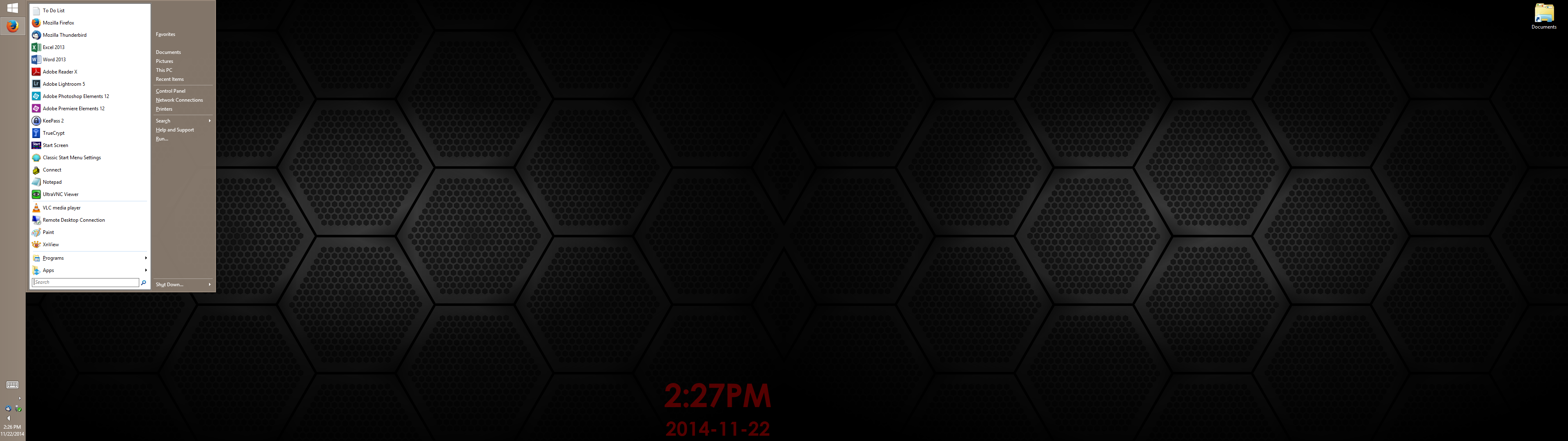

I was able to capture some screen shots, which I have attempted to attach. Perhaps this might help shed some light.
I didn't realize they would be attached for viewing in reverse order of their upload...

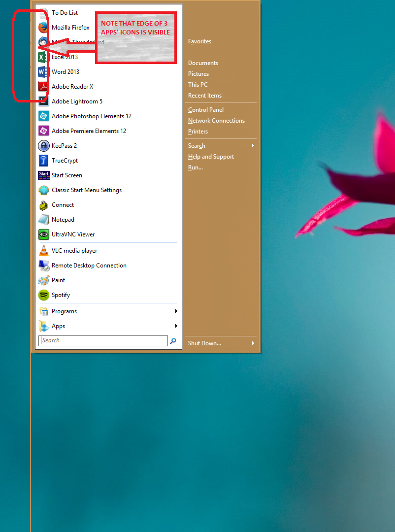

I encounter the missing Task Bar First, then I press the Start Button on the keyboard.
Don't know if that matters.
Thanks again for any insight.
File comment: This is what I see when I press the Windows button on my keyboard. The actual Start Menu looks and works as it should, it's the Task bar that is missing. Opening Classic Shell and going through the aforementioned procedure fixes the issue.
CSM - Floating Start Menu.png [1.22 MiB]
Downloaded 603 times
File comment: This is what I see when I mouse over to where the Task Bar should appear, which on my setup is the left edge of the screen. The white line offset from the edge of the image is the right edge of the Task Bar. If you look closely, you can see the right edges of the icons for open applications along it.
CSM - Start Bar Missing - Edge of Open Apps Icons Visible.png [1.5 MiB]

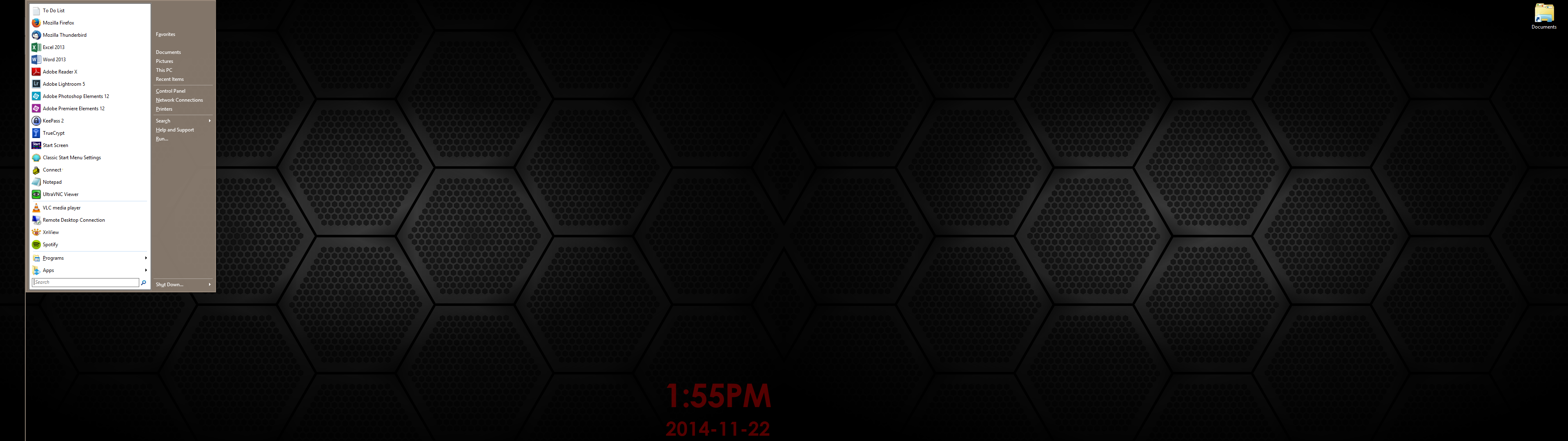

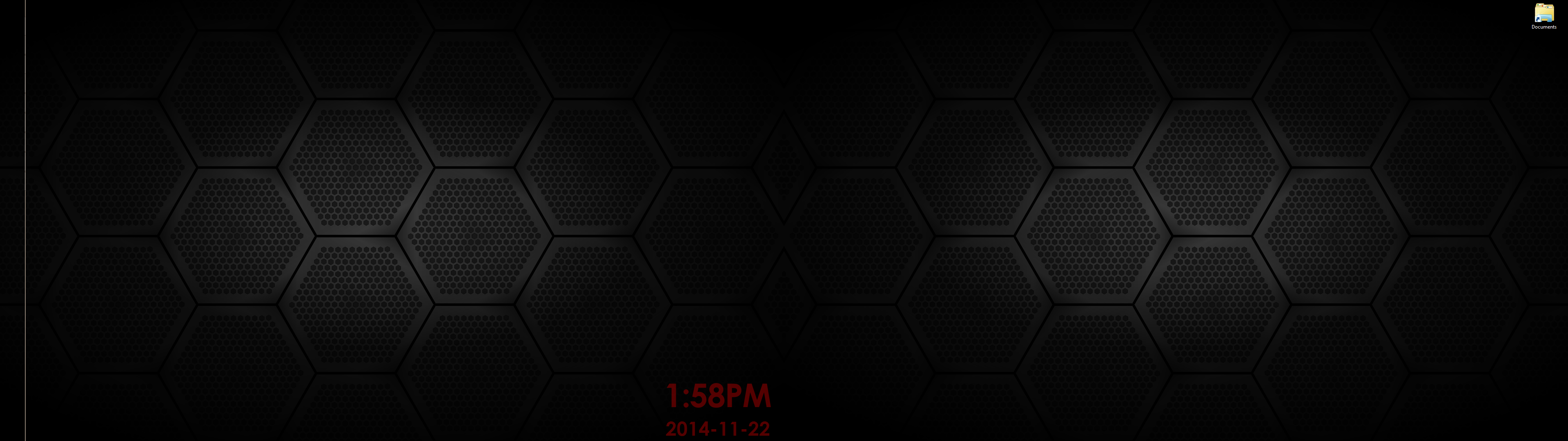

File comment: Missing Task Bar with a Windows default theme.
File comment: Floating Start Menu that Appears when I hit the Windows Key (with a Windows default theme).

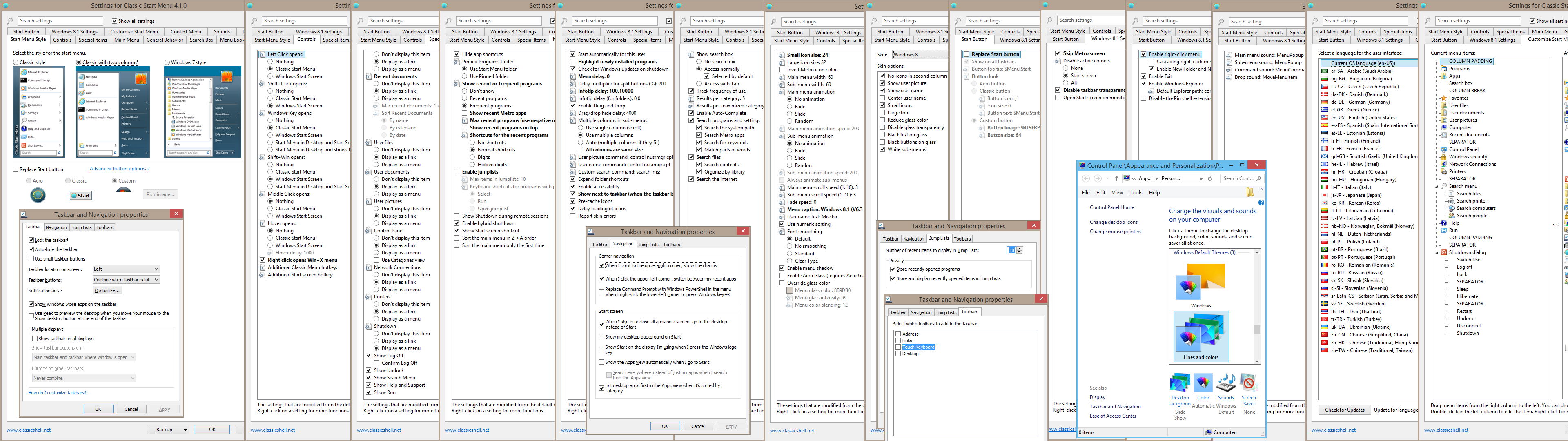

File comment: Relevant Settings
CSM, Taskbar and Theme Settings.png [532.55 KiB]
Downloaded 498 times
