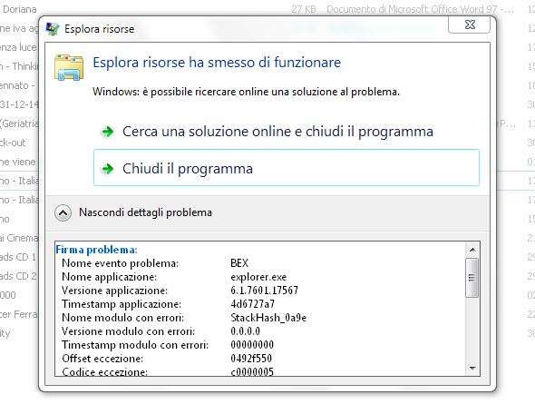

PostPosted: Thu Feb 19, 2015 2:04 pm
Joined: Sun Feb 08, 2015 2:29 am
Hi Ivo
I captured the crash log in Explorer (jpg images attached).
I hope you can resolve my issue.
Regards
