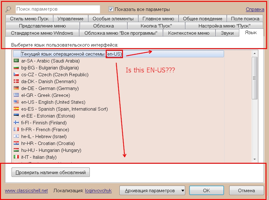

I have problem with correct interface language selection (not detection) with CS 4.0
Correct language is detected properly, but displayed wrong.
Windows 7 64bit prof English with MUI (russian). See attachment for explanation.
PS. If I forcibly set language to EN-US - everything becomes fine.

OK, so the issue seems to be that everything in the OS is in English (Windows start menu, Win+R box, etc), Classic Shell correctly identifies the current language to be en-US, but for some reason the settings and the classic start menu are in Russian.
And you want everything to be in English.
Is that correct?

I think his issue is that the settings dialog shows the language in Russian as expected but in the brackets (en-US) when it's in fact Russian?
Is that correct?
Hurrau! That's exactly what I wanted to say in my very first post :)

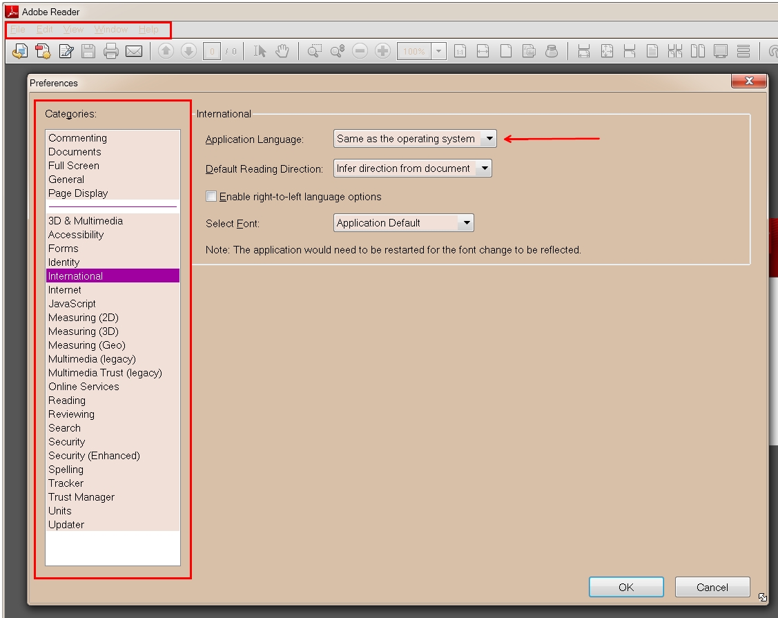

Moreover, other software detects UI language correctly (for example, take a look at Adobe Reader screenshot below).
