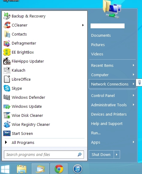

Hi there,
I am testing v3.9.1 and after contacting Gaurav, who asked me to post this, I am now reporting it.
On the main menu the icons at the top that flash up like a Windows 7 menu - one is corrupted.
All the icons work, except the Network Connections icon. This always appears as low resolution, while the other are high resolution.
If you go to: ClassicShell Settings | Customise Start Menu | Network Connections | Edit Item and then attempt to change the icon - whatever icon you change it to is always low res. once displayed.
I am using the regular RTM windows 8 Pro (*not* the 8.1 preview) and this always occurs even after deleting classic shell's and Windows own icon caches and rebooting. This is a repeatable problem with no answer.
[While I'm at it, I would also ask for a feature request where sub-menus can be added to the Network connections button (like the Classic menu style) in the new Windows 7 style look, showing wireless connections, etc. as well. It's a shame this feature/functionality was dropped in this look/style of Classic Shell.]
File comment: Screen capture showing the Low Res Network Connection icon in Classic Shell v3.9.1

I checked on Windows 7, and the icon for that item comes from C:\Windows\system32\netshell.dll. Open it with a resource editor and see if the icon there has sizes larger than 32x32.

Hi the icon is there but only in one flavour.
There is no difference if I select that or another icon from that collection. However, all the other icons on the menu are in hi res.....?

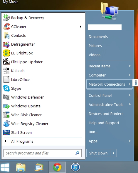

Fixed it - the defaut icon Classic Shell uses is pre-programmed to use: shell32.dll icon number 257,
Instead use C:\Windows\system32\netshell.dll icon number 5. That will fix this issue.

Just so you can compare, here's a screenshot of the now fixed hi res. icon.
File comment: Now fixed High resolution icon for the network Connection by changing path from Shell32.dll to the netshell.dll, icon #5
