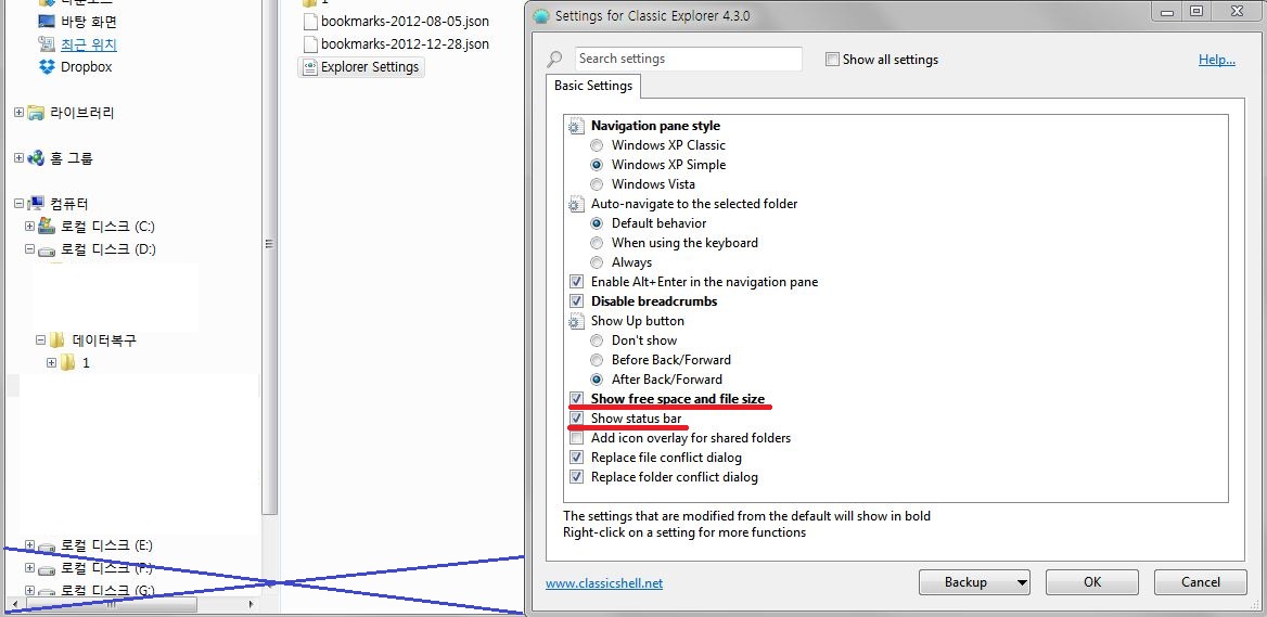

I've been used classic shell's explorer for years and it just happened
Suddenly, one of my adware cleaner started to take CH explore as threat, So I had to remove old version of cs's explorer then reinstall 4.3.0 version
somehow I can't see explorer's free space and status bar after I reinstalled new version
I did what the link(viewtopic.php?f=8&t=1580) said but most important features are not working
Please give me solution to use free space and status bar features again :(

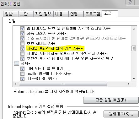

File comment: IE9 add on setting

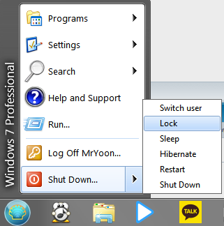

File comment: Classic Shell Start Menu works fine
File comment: Classic Shell Explorer features don't work

If you change the navigation pane style, does it have any effect? I'm trying to determine if any of the Classic Explorer features actually work.
I tried other styles to see difference but there was no change at all

See if the browser extensions are enabled, as shown here: http://classicshell.net/faq/#explorer_toolbar

No, I'm talking about the setting to enable third-party browser extensions.

Oh, that
Yes, still checked :(
