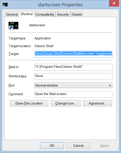

I have a similar but rather puzzling issue. The "Start Screen" button on the Classic Start Menu works fine but when I right-clicked and dragged it to the Quick Launch toolbar to create a shortcut there it doesn't work as expected. When I click on the newly created shortcut on Quick Launch (see first attached file below) it opens up the Classic Start Menu instead of going to the Start Screen. As you can see from the "startscreen Properties" dialog in the second attached file, the target for the shortcut is '"C:\Program Files\Classic Shell\ClassicStartMenu.exe" -togglenew' which is the same as the "Start Screen" button on the Classic Start Menu. Executing '"C:\Program Files\Classic Shell\ClassicStartMenu.exe" -togglenew' from the Run prompt also opens up the Classic Start Menu instead of going to the Start Screen.
I'm running 64-bit Windows 8.1 (w/latest updates) and I'm using Classic Shell Version 4.1.0 – general release so I didn't try the DLL fix since it is supposed to be fixed in that version.
Any ideas on why this isn't working?
Thanks!
Classic Start Menu - Start Screen button on Quick Launch - Properties.png [ 16.83 KiB | Viewed 30035 times ]
PostPosted: Wed Oct 15, 2014 5:08 am
In Classic Shell 4.2.1, the bug is finally fixed where the -togglenew command didn’t work on some Windows 8.1 systems with a touchscreen.
