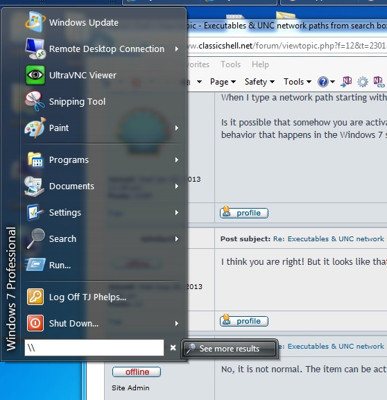

I think you are right! But it looks like that option is constantly selected and there is no way of unselecting it (at least for me) as soon as I type \\ and anything after it. Is that normal?

No what I'm saying is that seems to be my problem.... that is the ONLY option it's accepting so no matter what I enter after the "\\" as soon as I hit Enter it is the same as clicking on "See more results" (see screenshot). Does that make sense? Is there a way to disable the filtering all together so the search box acts just like entering a command from the Run window?
File comment: This is what it shows me when I enter "\\" from the search box. I'm sure this is my problem but how to fix??
PostPosted: Fri Mar 14, 2014 8:48 am
Ah, I see. You are using the Classic style. Now I can reproduce the problem. I will try to fix it for the next version.
In the meantime you can either switch to the Windows 7 style, or turn on autocomplete from the search settings.
